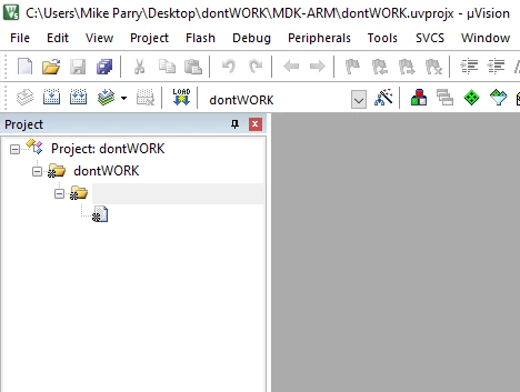

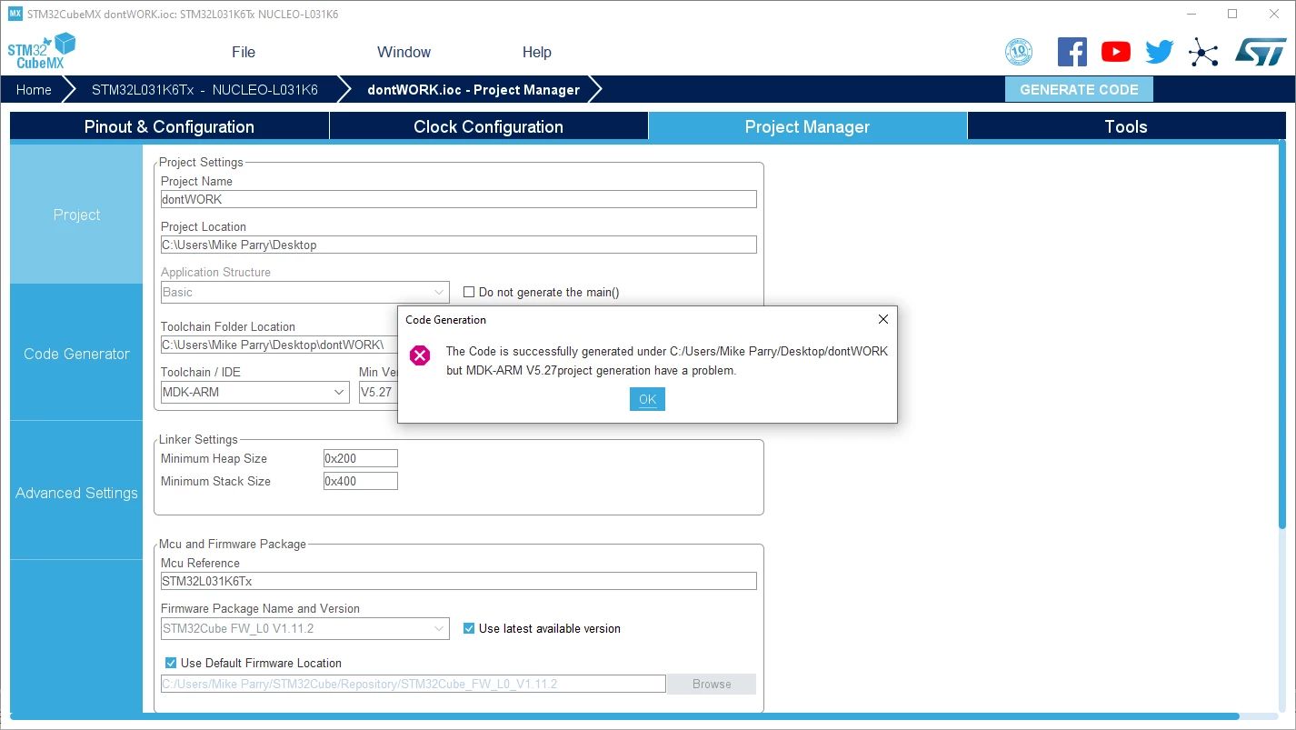

How to create a MDK-ARM Project with CUBEMX 5.6.0
I have recently switched computers and i have installed Keil IDE and CubeMX 5.6.0 onto the new PC, but when i create a project i get an error saying:
"The code is successfully generated under........ but MDK-ARM V5.27 project generation have a problem"
I have tried multiple different locations to see if it was that causing the problem , but no change.
I installed CUBEMX 5.5 and 5.4 and they both show this problem however if i used V5.3 the project generates successfully.
i can obviously just work from V5.3 but this would mean i cant open any recent projects
Any help would be appreciated -i'm out of ideas what to try

Hello @MikeP​
Could you please share your .ioc to check the issue.
Best regards,
Nesrine

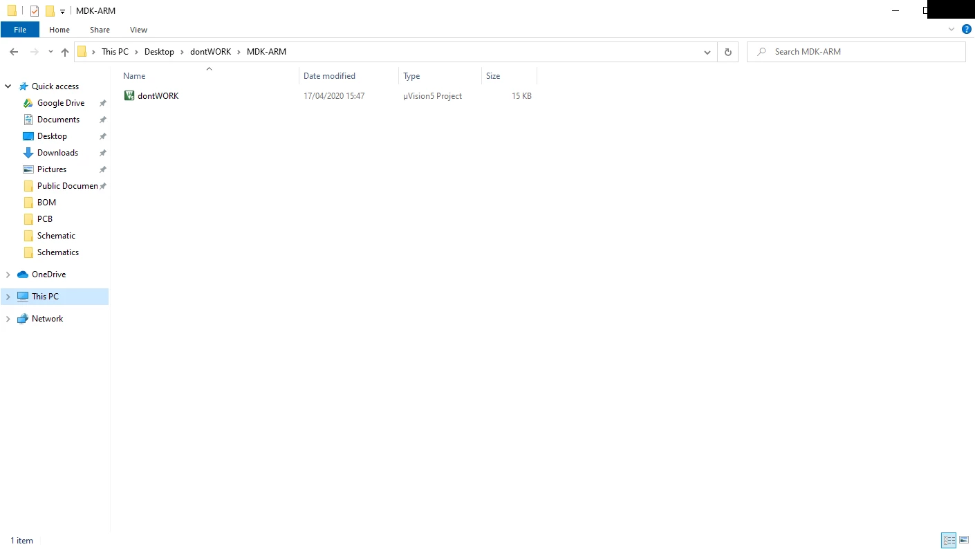

MikeP
MikePAuthor
Apr 21, 2020 7:10 AM UTC
Hello @Nesrine.JLASSI​
Thank you very much for your reply. I have attached a Zip file with my project, (i have generated for both MDK-ARM and the CubeIDE)
I look forward to your findings!
Kind Regards,
Mike
Nesrine.JLASSI
Visitor II
Apr 21, 2020 9:49 AM UTC
Hi @MikeP​
I just reproduced the same scenario and I had no problem (neither with keil nor STM32CubeIDE). it work correctly.
Please try to uninstall then reinstall MDK-ARM (try with version v5.29).
Best regards,
Nesrine
MikeP
MikePAuthor
Apr 21, 2020 11:05 AM UTC
Hi @Nesrine.JLASSI​
Thank you for looking into this.
I have uninstalled then reinstalled Keil MDK-ARM v5.29 (with Windows uninstaller) but this hasn't worked and i am getting the same error. I also tried a new project
Kind Regards,
Mike

MikeP
MikePAuthorBest answer
Apr 24, 2020 8:14 AM UTC
Good Morning,
I exausted all options and ended up wiping my computers HDD and resetting everything to factory setting
Thankfully this worked
Very bizarre situation especially how a previous version would work,
Thanks,
Mike
