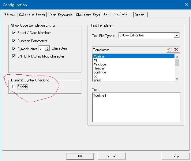

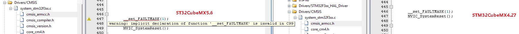

How to correct the waring of __set_FAULTMASK(1)?
  • February 26, 2020
  • 4 replies
  • 2963 views
0690X00000DXMNtQAP.pngThere is a warning of __set_FAULTMASK(1) when using the STM32CubeMX5.5/5.6 to generate the code for the STM32F334, how to correct it. Thanks!

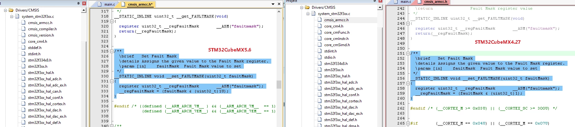

Which compiler? Keil?
Then it should be in .... /Drivers/CMSIS/Include/cmsis_armcc.h
hw.1
hw.1Author
February 27, 2020
yes,the compiler is Keil 5.29. cmsis_armcc.h have the definion of it.
Migrate the project from STM32CubeMX4.27 to STM32CubeMX5.6 and regenerate the code, have the warning in the Keil.
hw.1
hw.1Author
February 27, 2020
hw.1
hw.1Author
February 29, 2020
thanks, in the kEIL   Edit→configuretion→Text Completion→Dynamic Syntax Checking ( cancel it )0690X00000DYLpAQAX.png
