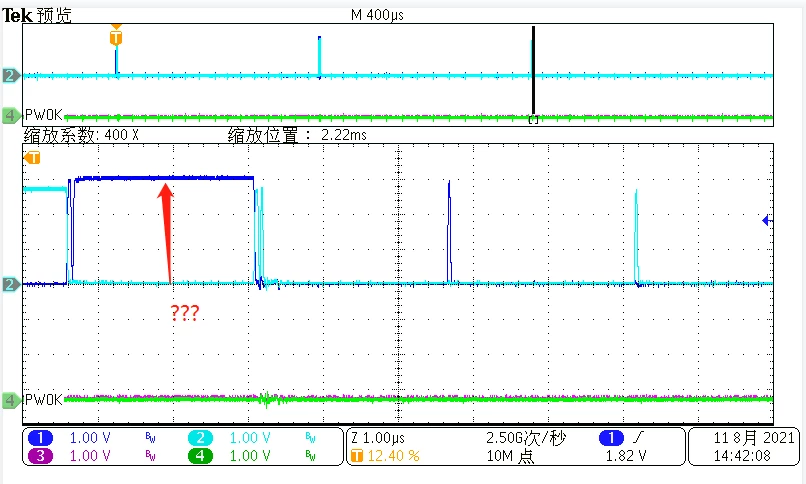

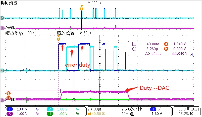

How to configure the STM32G4 HRTIM to control a half-bridge LLC converter with synchronous rectification?
Please check my ico and code,What is wrong with my configuration?
TIMA and TIMB must be updated simultaneously with the master timer repetition event.
2 replies
JGrap.1
Aug 13, 2021 5:22 AM UTC
My configuration is using 'Reset Trigger' instead of 'Update Trigger'.
JGrap.1
Aug 13, 2021 5:27 AM UTC
and I also enable Repetition Update for both TIM.
This's work for me. hope it help you. too.
