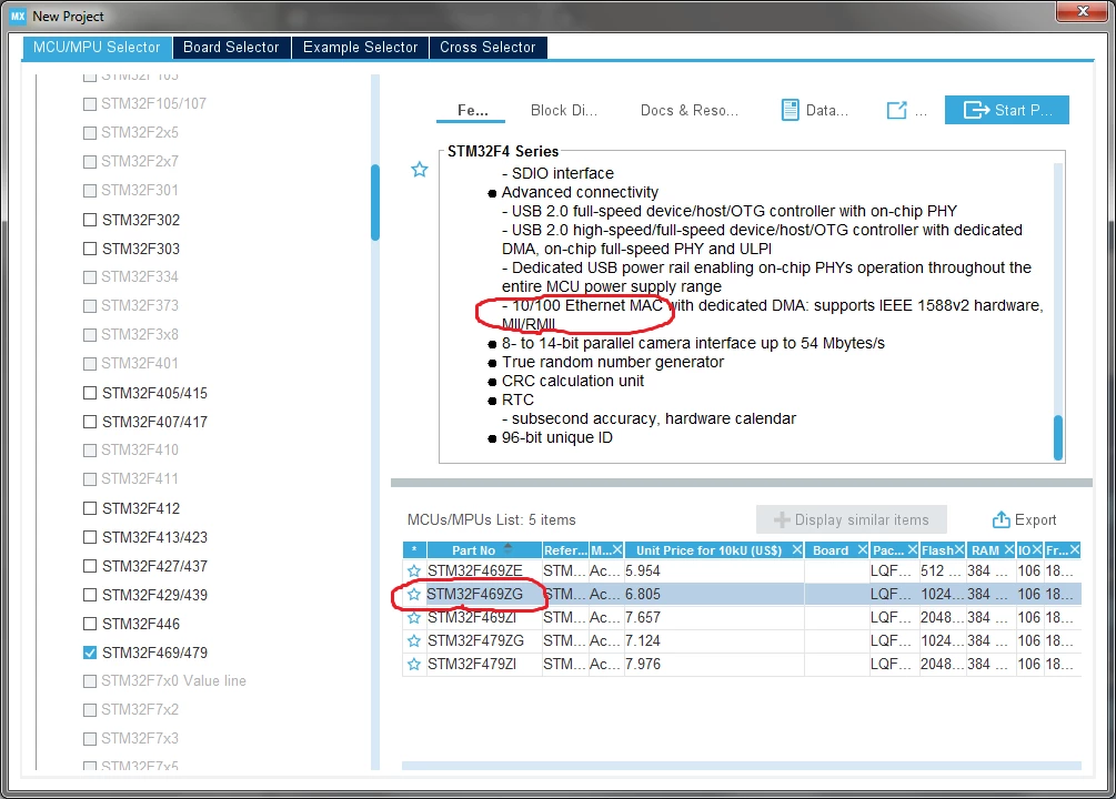

How to configure STM32F469ZxT Ethernet in CubeMX? There is no "ETH" item on "Connectivity" page. However acording to datasheet ethernet supposed to be supported.

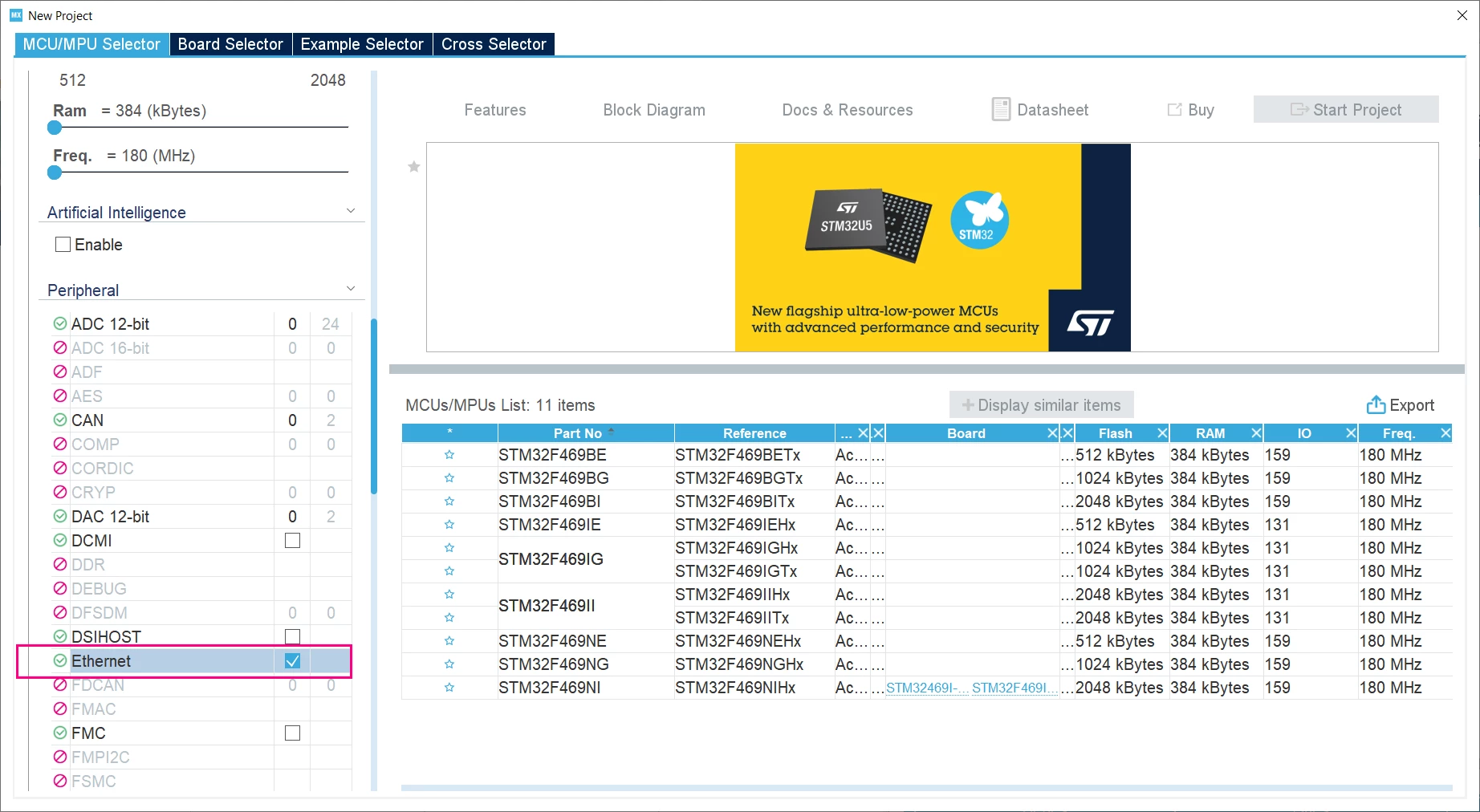

Hi @OKoch.1​ ,
thanks for your feedback.
I will raise this issue internally to be fixed.
Meanwhile, to detect which F4 MCU contain ETH, you can do search by selecting "Ethernet" in peripheral list of MCU selector as explained in the screenshot below :
0693W00000AM7PbQAL.pngHope this helped you, if your question is answered, please close this topic by choosing Select as Best. This will help other users find that answer faster.

Hence, STM32F469Z does not support Ethernet. Am I right? But the description of MPU features in CubeMX contains Ethernet. This is quite confusing.

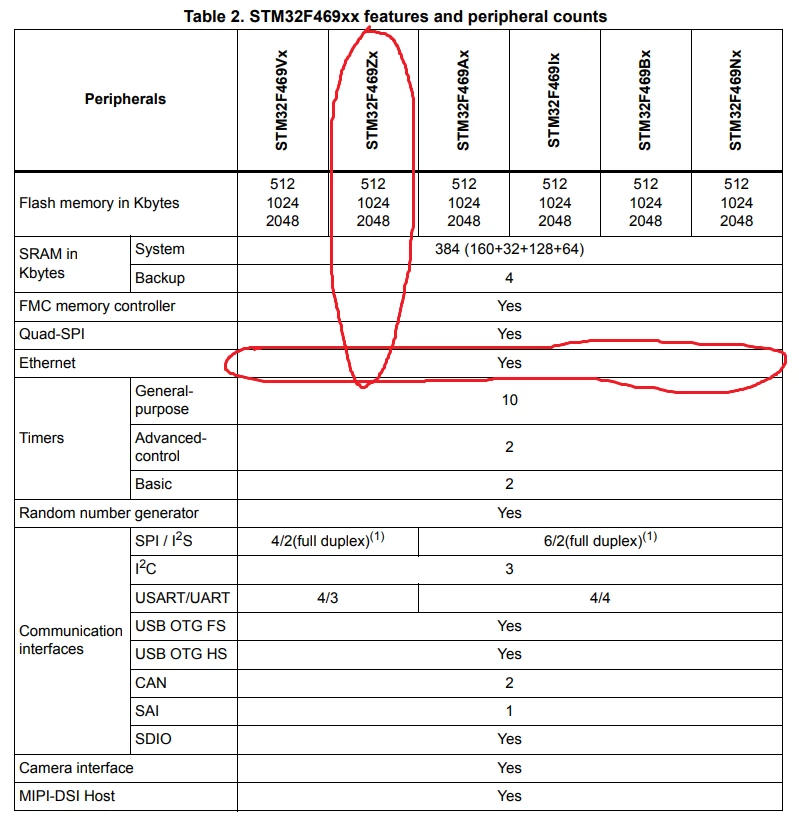

Hello @OKoch.1​ ,
Sorry for the delay.
Yes the datasheet need to be aligned.
The configuration in STM32CubeMX is correct.
Hope this helps you.

Hi @OKoch.1​ ,
I confirm what was said by @Houda GHABRI​ . The STM32F469/F479 datasheets are already updated (see DS11189 and DS11118).
Please note that even if Ethernet is running successfully on some parts, ST cannot guarantee its full functionality on STM32F479V/Z/A.
