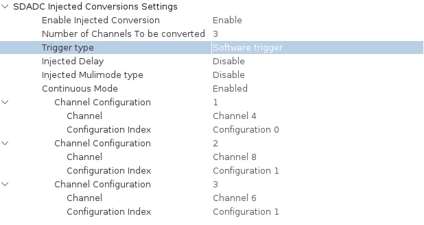

I think there is a lack of information to configure a Sigma Delta ADC 16-bit in STM32CubeIDE and I want to configure:
  • 2 Single ended zero reference
  • 3 Differential ended
So I have a lot of questions for the STM32 Team here.
I begin first to configure on SDADC1.
Then I select 3 conversions because I have 1 Single ended and 2 Differential ended
0693W000006EzljQAC.pngI want VDD = 3.3v to be my reference voltage and I don't want low power mode and fast conversions mode.
0693W000006EzmNQAS.pngDen I select my conversions:

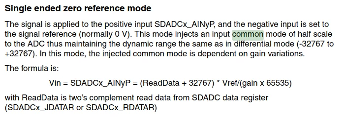

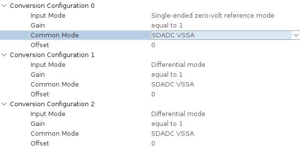

Question:
What is "Common mode"? I have read the document AN4207 and I don't know what Common Mode has to do with Differential mode? I know that VSSA är analog ground.
Now it's time to configure the settings.
0693W000006F05PQAS.pngQuestion:
What should I select?
Assume that I'm selecting Regular and I want my SDADC1 to sample values continuously.
0693W000006F06wQAC.pngQuestion:
What is Mulimode type?
Assume that I'm selecting Injected.
Question:
What is Configuration Index?
What is Injected Delay?

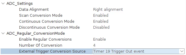

Assume that I'm selecting an external trigger, instead of letting the processor handles when I should sample for SDADC1.
Question:
Why have the other ADC have External Trigger source as Output but SDADC1 have Output Compare as trigger source?
Is it better to select an external trigger source for SDADC1 in this case?
Does Output Compare means that every time there have been a change in the differential inputs, or single ended zero reference input, the SDADC1 should take a sample?
This picture is from ADC1 and not SDADC1.
