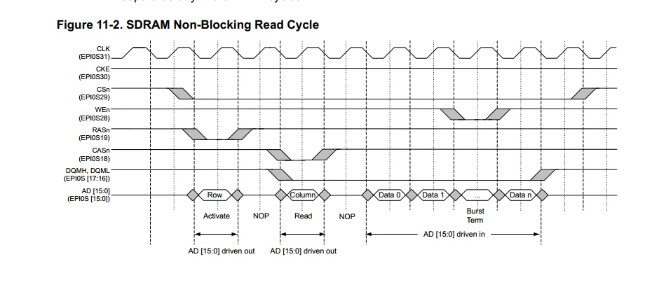

That's informative, thank you. I'm coming from a TIVA project where we shared the Address and Data pins on the MCU so that the total pin connections was 32 (for 16bit data). The exchanges first programmed the address on the data lines and then the data itself, as shown here. What I think you're saying is that there is no way to mux the address and data pins, they are all needed in parallel. That would certainly require way more pins.0693W000000VFo3QAG.png

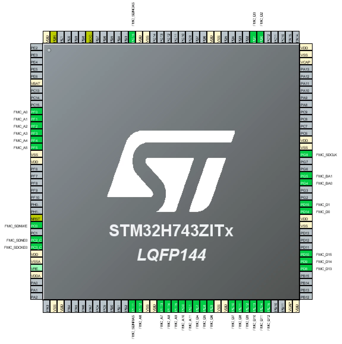

as a side question, can i assign the SD related operations by hand to GPIO? Is there a higher level config controller that I could write to make the normal FMC work?
Apr 3, 2020 3:31 AM UTC
STM32CubeMX will happily do this for you.
Edit: I was using LQFP144, not LQFP100. There is no SDRAM configuration available on LQFP100.
Not sure what you mean. You have to use the SDMMC peripheral for SD functions. No way you're going to bit bang those with any amount of speed.

As for the shared address/data scheme as you've outlined above (from the Tiva manual) - interesting concept, but I don't think the STM32 FMC module supports this, see SDRAM controller subchapter of FMC chapter of RM.
As TDK said (pointing out that SD is Secure Digital (for which SDMMC is the interace to be used) - but the same is valid for SDR SDRAM (Single Data Rate Synchronous Dynamic RAM)), you can bitbang the interface, but you are not going to achieve any reasonable speed.
