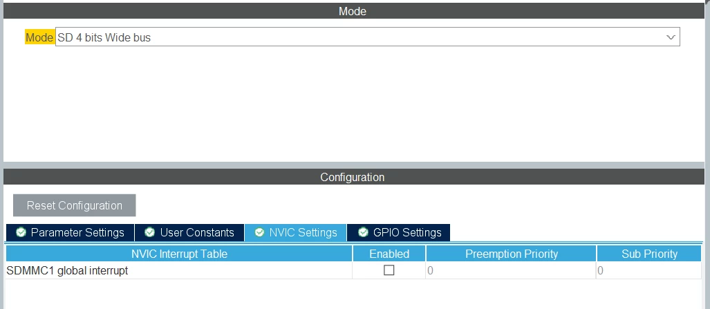

I would like to know how to configure the SD card of an STM32L552E-VE evaluation board, I have an example with this evaluation card 'FatFs_uSD_Standalone' but It's not easy for me to understand how to configure the 'SDMMC' with this board since there is no '.IOC' file. I have the example code but not the '.IOC' configuration file. Can anyone tell me how to configure the SD card via STM32CubeIDE ?

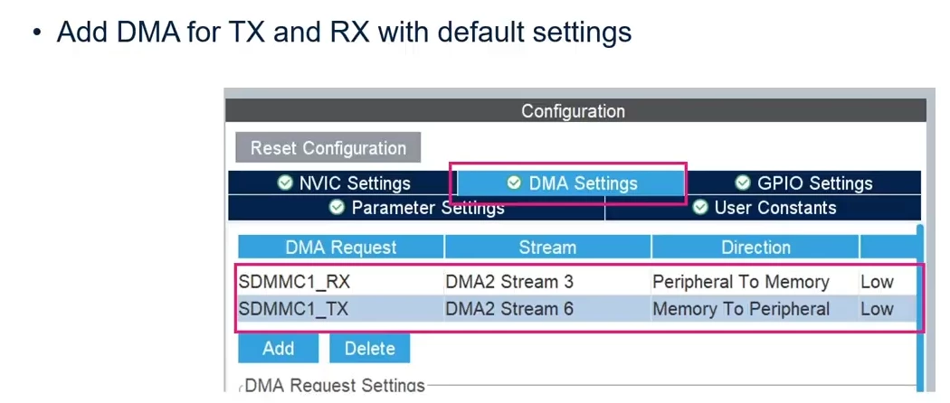

This video shows how to configure SD interface using CubeMx for FatFs file system usage .
Hope it helps.

I can see the video but in this step I don't have the same configuration
And my evaluation card does not have a DMA tab? Maybe I'm missing a library ?
Yet the NVIC is activated. Probably the STM32F7 board is not the same as STM32L5 that why I don't have the DMA tab ?

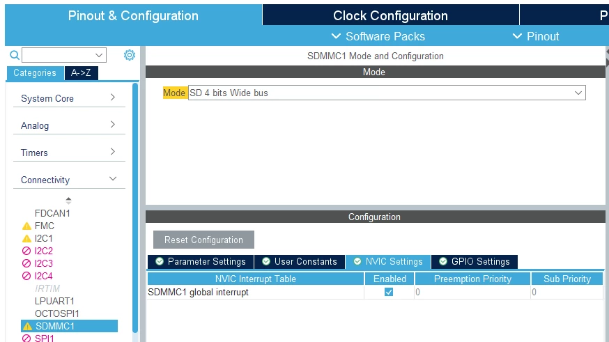

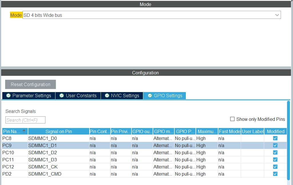

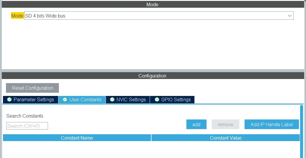

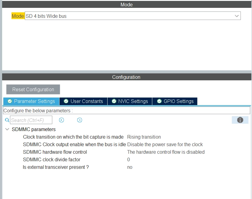

June 24, 2024
this config of SD card on STM32L552E-VE board can help you. If you use SD card for the application 'FatFs_uSD_Standalone' must enable SDMMC1 global interrupt.
I will be waiting for your feedback.

June 24, 2024
Hello M. Elhem,
Thank you for this information, after having verified I don't have the SD card but the µSD card, I think it's the same communication protocol for both ? Should I check the box 'NVIC Interrupt Table' or not ? After your previous picture we don't  validate NVIC Interrupt Table.

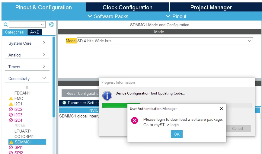

When I try to generate de code by STMCubeIDE I have this message :
Thanks
DYann.1
DYann.1Author
Senior II
June 24, 2024
After login and download the update now i can have the code, now I can compare with the example code. Thank you.

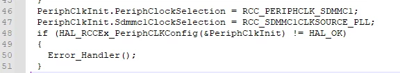

I have this example as I said at the beginning of my topic. And in this example (FatFs_uSD_Standalone) I have this code in the function void SystemClock_Config(void) :
 RCC_PeriphCLKInitTypeDef PeriphClkInit = {0};
 if (HAL_PWREx_ControlVoltageScaling(PWR_REGULATOR_VOLTAGE_SCALE0) != HAL_OK)
 Error_Handler();
 RCC_OscInitStruct.OscillatorType = RCC_OSCILLATORTYPE_MSI;
 RCC_OscInitStruct.MSIState = RCC_MSI_ON;
 RCC_OscInitStruct.MSICalibrationValue = RCC_MSICALIBRATION_DEFAULT;
 RCC_OscInitStruct.MSIClockRange = RCC_MSIRANGE_6;
 RCC_OscInitStruct.PLL.PLLSource = RCC_PLLSOURCE_MSI;
 RCC_OscInitStruct.PLL.PLLM = 1;
 RCC_OscInitStruct.PLL.PLLN = 55;
 RCC_OscInitStruct.PLL.PLLP = RCC_PLLP_DIV7;
 RCC_OscInitStruct.PLL.PLLQ = RCC_PLLQ_DIV2;
 RCC_OscInitStruct.PLL.PLLR = RCC_PLLR_DIV2;
 Error_Handler();
 RCC_ClkInitStruct.APB1CLKDivider = RCC_HCLK_DIV1;
 RCC_ClkInitStruct.APB2CLKDivider = RCC_HCLK_DIV1;
 if (HAL_RCC_ClockConfig(&RCC_ClkInitStruct, FLASH_LATENCY_5) != HAL_OK)
 Error_Handler();
 PeriphClkInit.PeriphClockSelection = RCC_PERIPHCLK_SDMMC1;
 PeriphClkInit.Sdmmc1ClockSelection = RCC_SDMMC1CLKSOURCE_PLL;
 if (HAL_RCCEx_PeriphCLKConfig(&PeriphClkInit) != HAL_OK)
 Error_Handler();
 This part of code is very strange and misplaced
I was looking for something that I already had since I configured it in my .ioc file via STM32Cube IDE but which is placed elsewhere not in the function 'void SystemClock_Config(void)' but in the function 'void HAL_SD_MspInit(SD_HandleTypeDef* hsd)'. Thus It's impossible to compare to something that is not comparable. Why are you hiding the '.ioc' file in the FatFs_uSD_Standalone example ? What is your interest in wasting developers' time ?

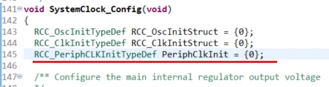

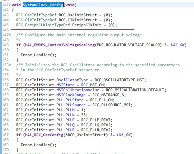

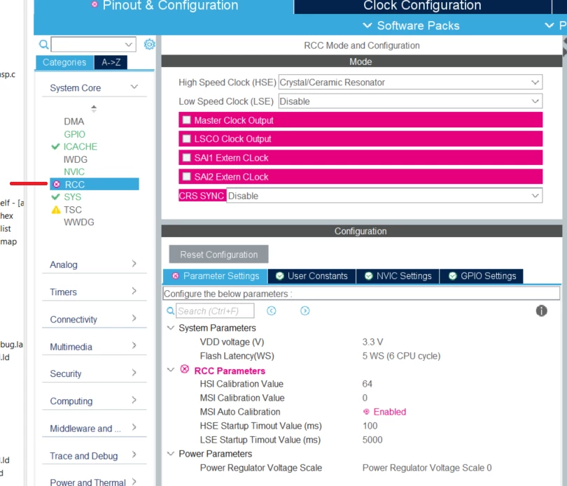

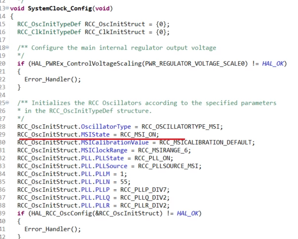

I would like to know how to have the configuration have the same code from the STM example via the .IOC file.
The example has this code
Via my STM32CubeIDE, after configuring my Clock Configuration I can have this code
I'm missing this line below, is this really important ?
And my .ioc file has a red cross
Do you have any idea how to configure my clock to have the same code as the example provided by STM ? Thank you for your helps.
