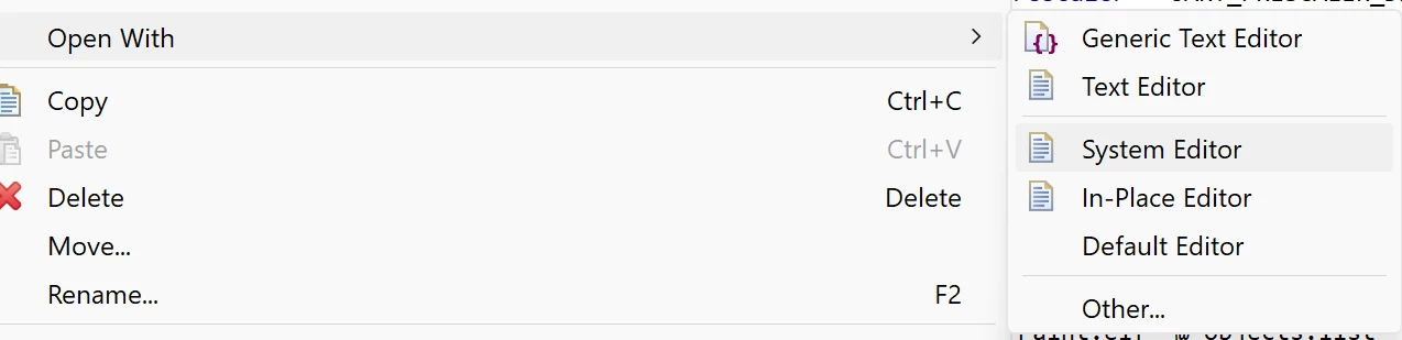

It should open in the system editor if an editor is not explicitly defined. If you right click the PDF within STM32CubeIDE and then select Open With -> System Editor does it open in the system editor?
If you double click it within Windows Explorer, does it open in the system editor?
You can hard-code an editor for *.pdf files here:
Try Window > Preferences > General > Editors > File Associations
In Eclipse, how do I make a .pdf file open with the System Editor by default? - Stack Overflow
Maybe open that up and ensure it's not hard-coded to use Adobe.

If I use File->Open File in cubeIDE and select a PDF file it does open correctly in the default application configured in Windows settings.
Apologies for the confusion. It's cubeMX that is misbehaving, not cubeIDE.
