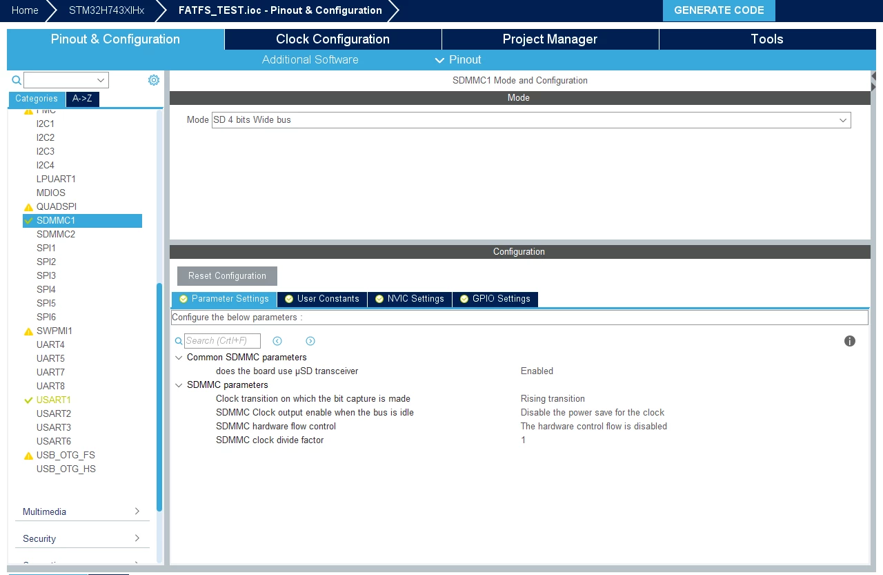

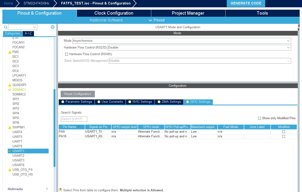

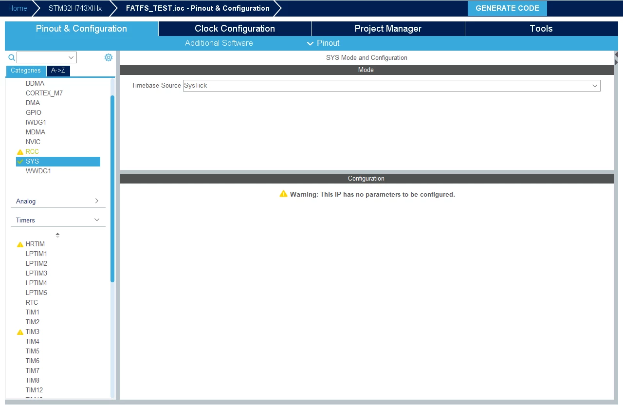

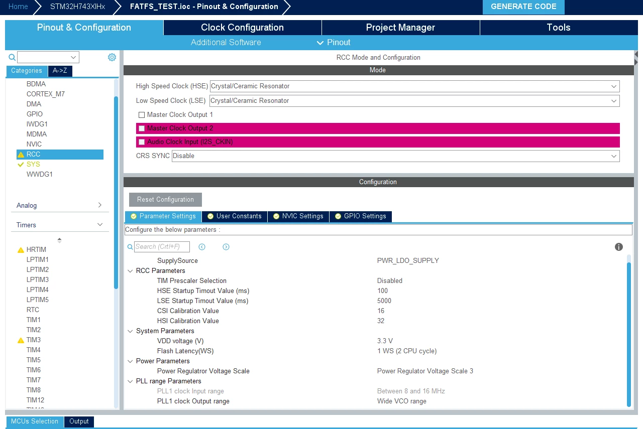

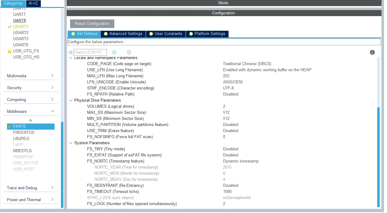

How to Configure FATFS for SDMMC ?
Hi ,
I`m trying to build a project with STM32CubeMX and use FATFS for SDMMC ,then print it with UART on screen.
Here is the configuration on CubeMX.
(If I configured wrong way,then you can tell me! I`ll appreciate that)
I have built it for many times, but when I ran on my development board, it could`t open directory root and came out error like FR_DISK_ERR.
I have checked my card and it work well,so I exclude the problem.
​I want to figure out that I configure it wrong way or not.
Hope anyone can help!
Really Appreciate !!

in the option FATFS -> PLATFORM SETTINGS do not forget to set the input pin, which is responsible for the installed memory card, otherwise the initialization will fail (0 - there is a memory card, 1 - no)

You mean Detect Pin right?
I have set it already.
I just view the website you provide,it seems a little bit different with mine,but still Appreciate.
I`m wondering if there any example or method can give me some advises.
Yes
CUBE MX generates the wrong code for processing the interrupt for transferring data to the SD card, I didn’t get write to the file and closed it because of this, the transfer handler just didn’t get called, for some reason, I don’t know, I didn’t dig further
in this example, everything is well described, which is attached to the topic that I threw you, she helped me
