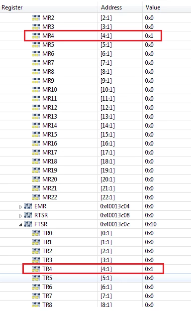

I know that this is an old thread, but I have an identical need - that is, have an external interrupt on the MISO line while the SPI is enabled.
Here are a few code snippets from what I have, but for some reason, I cannot get the external interrupt to trigger.
The processor is an STM32F407.
The interrupt is connected to the MISO line (PB4).
The interrupt is to be negative edge triggered.
 // Configure PB4 (EXTI4) for falling edge trigger
 // Enable EXTI4 interrupt in NVIC, but don't enable
 // the local ISR enable until we are ready.
 EXTI->FTSR |= EXTI_FTSR_TR4;
 NVIC_EnableIRQ(EXTI4_IRQn);
// Enable global interrupts
__enable_irq();
	// Enable external ISR on PB4
	EXTI->IMR |= EXTI_IMR_MR4;
Looking into the EXTI registers, I see that the interrupt is enabled, and falling edge triggered.
Of course, I am not using HAL. I don't trust him - you know why.
What am I missing here ?
Thanks in advance.
waclawek.jan
November 9, 2021
You have to select the proper port in SYSCFG_EXTICR.
