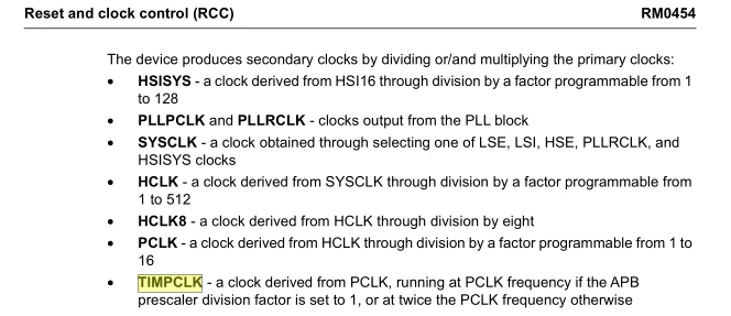

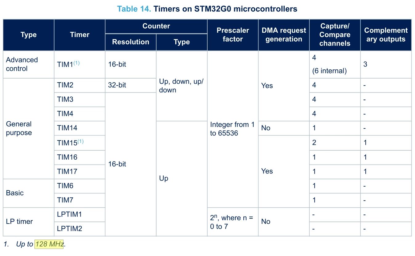

Relevant information in the datasheets and reference manual (RM0454) is lacking and/or confusion, but that 128Mhz can be achieved is clearly stated (STM32G030):

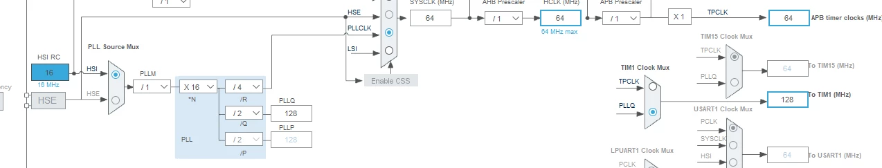

Cube also does allow for me to put in a 128 value for the ABP timer clocks (tested for both the STM32G030 and STM32G070), as shown below:
But when I look at the generated code (for TIM1), there is no code change when compared to the version generated for a 64Mhz input value. Note that Cube is erratic after changing values in this area: sometimes it updates the code sometimes it doesn't.

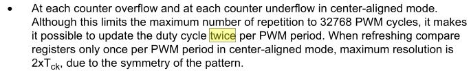

So my question is how to configure 128Mhz operation. Is it through the timer clock, or some center-aligned PWM configuration as suggested below:
That's it. Here's some extra tidbits found (from the refman):

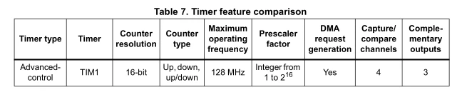

0693W00000KbfyfQAB.pngFrom the datasheet:

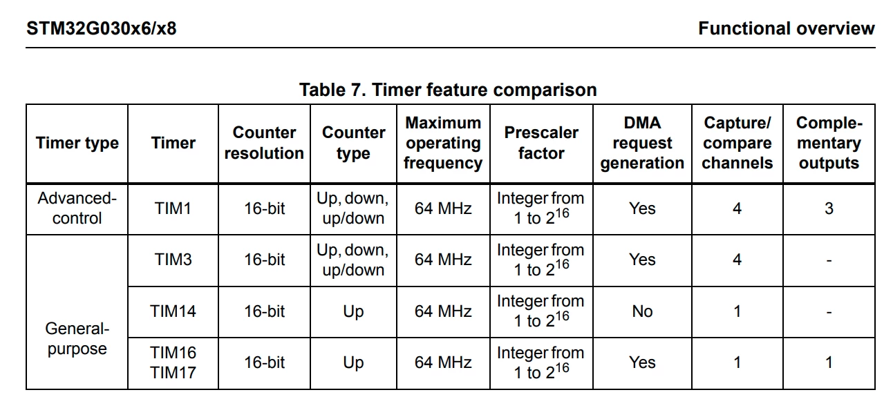

The STM32G030 datasheet specifies 64 MHz max timer frequency.
https://www.st.com/resource/en/datasheet/stm32g030k8.pdf
Other STM32G0XX chips may support higher, which is consistent with "up to 128 MHz".

Mar 7, 2022 2:20 PM UTC
Seems like a CubeMX bug that lets you edit that field independently. It's not configurable independently of HCLK/APB Prescaler.
I can duplicate but I do get warning messages which indicate abnormal behavior.

Ouch. So I tested this with several G0x0 versions, including the STM32G070, and it seems all G0x0 don't feature the 128Mhz PWM.
For those wondering, using the STM32G071 I could configure 128Mhz:
So I guess the Cube bug and the blanket comments about 128MHz TIM1 capability put me on the wrong footing.
I'm glad it's worked out, thanks TDK.
