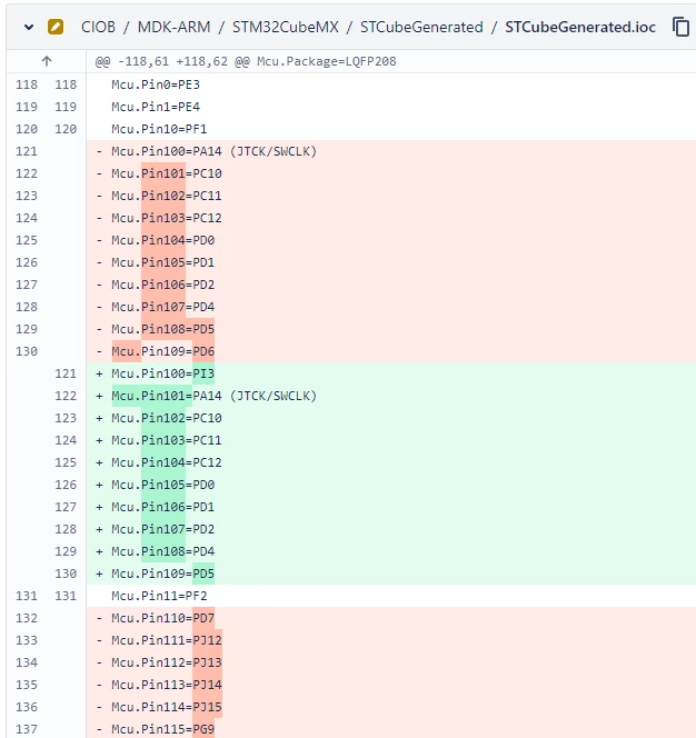

The problem with merging changes to the ioc file generated by the CubeMX configuration tool is not as simple as merging two text-based source files with localized conflicts.
The issue is that CubeMX uses some sort of MCU pin enumeration scheme to associate IDs to physical pins in the ioc file. When a change is made on one branch, it may associate a new physical MCU pin with an existing enumeration index, sliding all other enumerations in sequence after it down and completely changing the mapping of MCU pin enumerations to physical pin names in the map. I'm unsure of the repercussions of this, but it seems very impactful.
See the attached screenshot of a small excerpt from a Bitbucket pull request showing the issue I'm describing. In this case, CubeMX was used to change the configuration of 3 or 4 pins associated with a single SPI port on an MCU with hundreds of pins. This resulted in hundreds of lines of changes mostly associated with reassociating most of the physical MCU pins with a different enumerated MCU pin ID.
If changes like this occur on separate branches it will create conflicts throughout the bulk of the file when merging. How do you simply and accurately resolve such a sweeping merge conflict in an ioc file?
The pattern above continues on down through line 270 of the IOC file.
