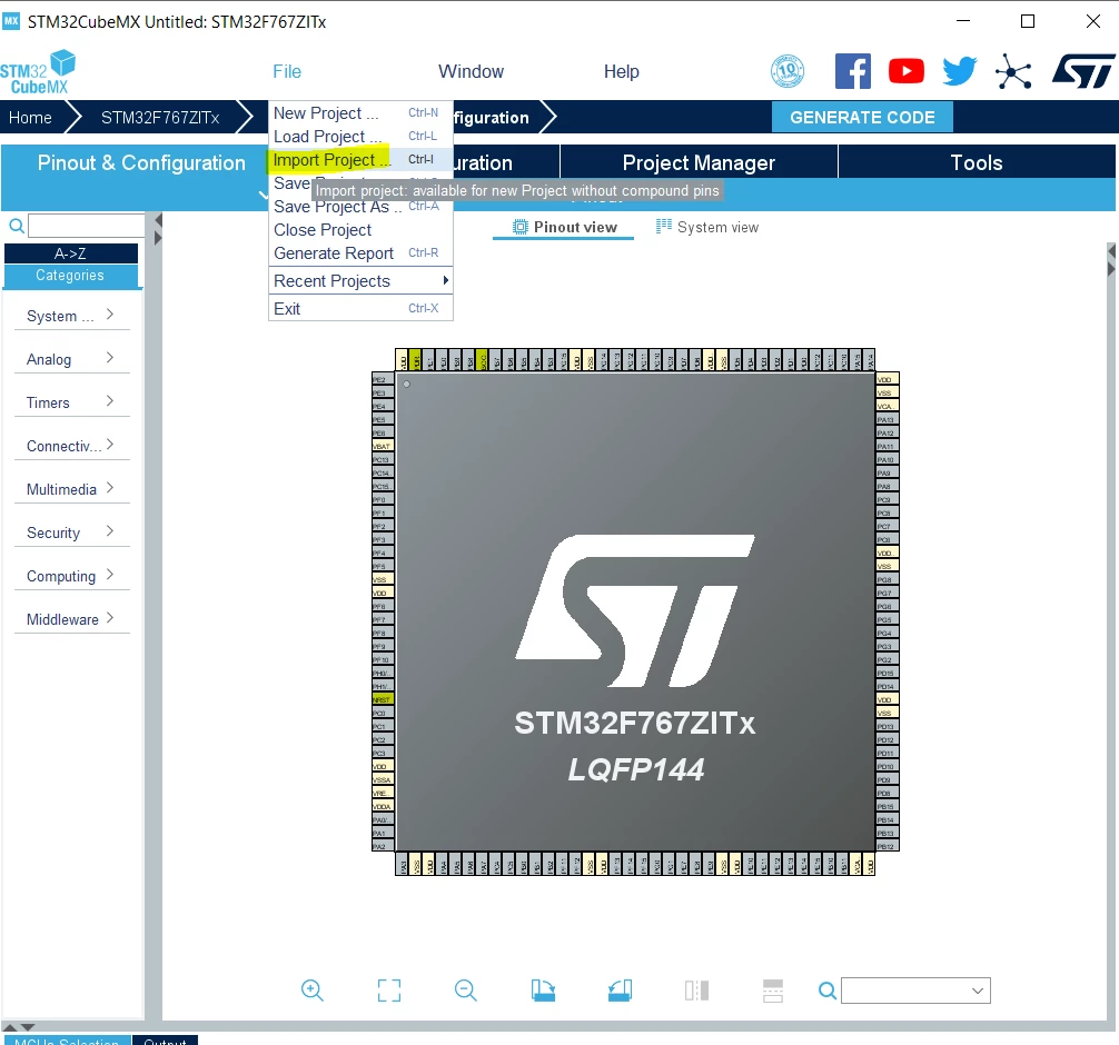

Hi @NW27​
You can simply do the import of your project.0693W000004KWUsQAO.pngBest regards,
Nesrine
