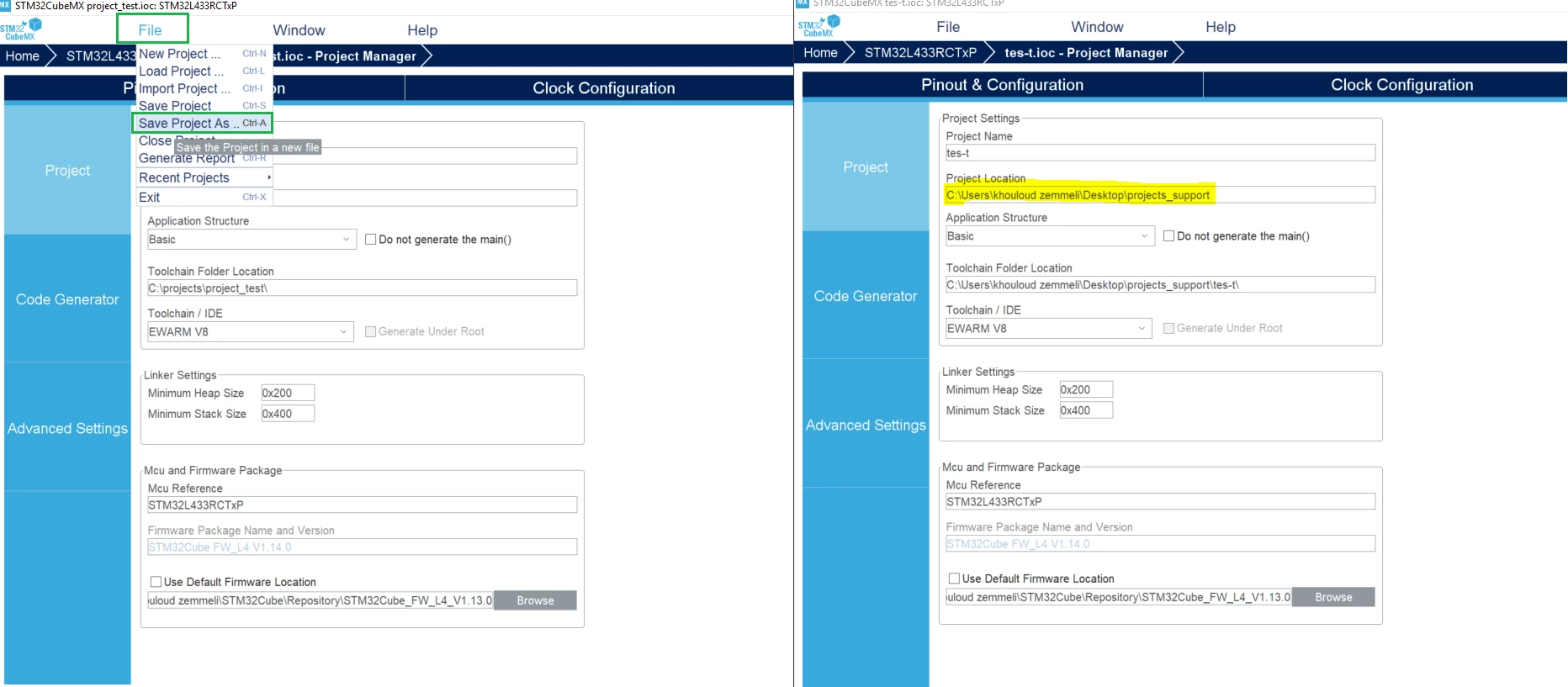

I have just installed CubeMX 5.2.0, and opened an saved Cube .ioc file. When I go to Project Manager the path to "Project Location" seems to be fixed to <Cube Project dir>/<Project name>
I've uninstalled Cube, deleted all directories and files related to Cube, gone thru registry to make sure no entries are remaining. And then installed Cube again.
But when I open the Cube .ioc file I get no chance to change the Project Location.
Do I have to start all over again and define all pins and so forth just to be able to change Project Location??? Isn't there a quicker way ?

​Hello @Mats Webjörn​
you can change the Project Location when you Save it "As" .. , then select the location you want.
