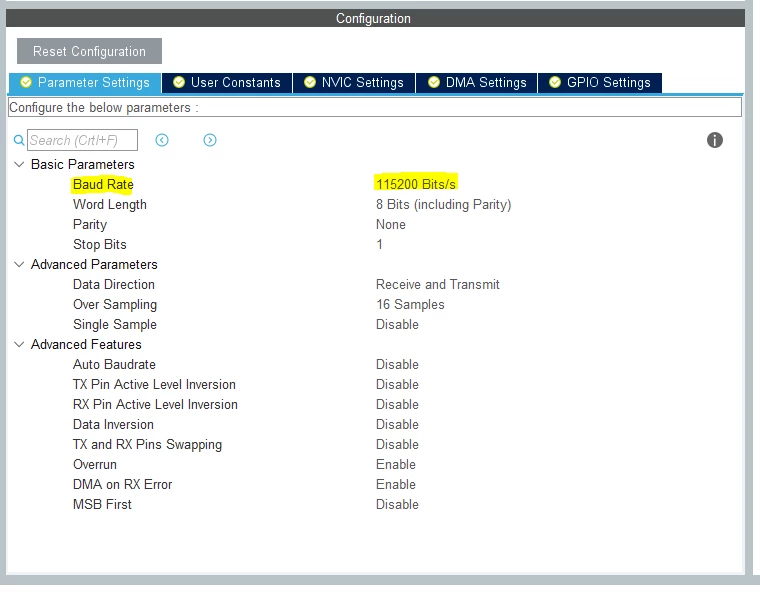

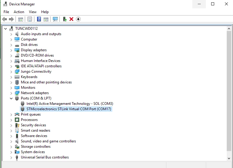

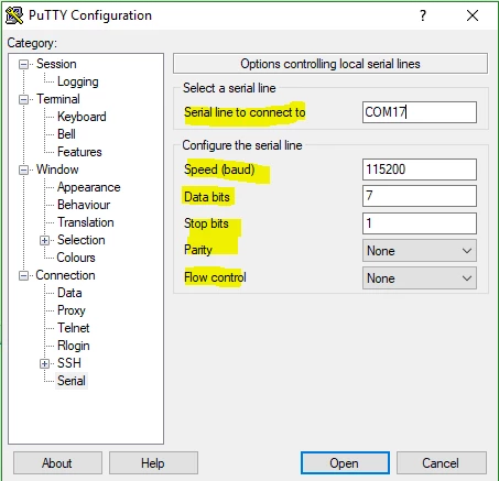

  8. Open PuTTY => Putty configuration : put the same configuration of CubeMX: Speed, data bits, stop bits, parity and flow control.0690X000008AlVxQAK.png

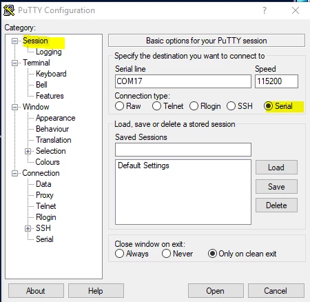

  9. Go to session => Connection type: Serial0690X000008AlWWQA0.png
