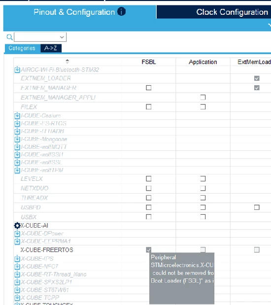

Hello, I have a simple CubeMX project with the STM32N6 MCU, and I cannot seem to be able to uncheck the FREERTOS option from the FSBL to move it to the Application.  Is there something I am doing wrong?
Thank you

Hello @Cococarbine
Let me thank you for posting.
You need to enable the X-CUBE-FREERTOS package from Software Packs.
Thanks.

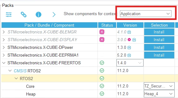

Sorry I am newer to this MCU - it turns out you have to select the dropdown above to switch the context to Application:
You cannot uncheck/check the checkboxes on the lefthand menu.
