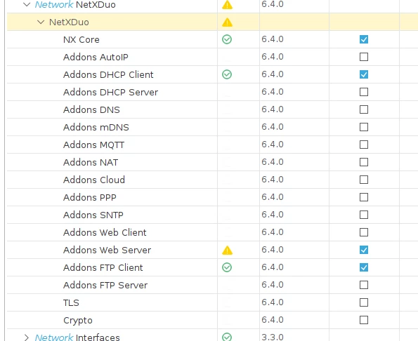

How to add Netxduo TFTP on CubeMx?
i am using netxduo in one of my projects and need to use TFTP addon. I am wondering how to activate / install this addon in software selection. There are also some other addons missing.
How is it supposed to install and use such missing addons?

So the question here: How to add Netxduo TFTP on CubeMx?
AZorn.1
AZorn.1Author
Jan 3, 2025 8:26 AM UTC
yes.
Compared to the available addons on NETXDUO GitHub, there are less addons available in CubeMX, as you can see in the screenshot:
by now, i only need the TFTP.
thank you

I'm asking that question internally (ticket number 200261). I'll get back to you as soon as I have an answer/feedback.

Jan 14, 2025 12:43 PM UTC
According to the dev team, CubeMx doesn't support TFTP and there is no plan to support it for the moment. You can use FTP instead.
Sorry for any inconvenience.
