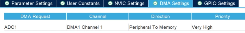

I've been confused for days and am unable to make the ADC work on F103RC and have to seek for help.
The test consists of ADC1 with 6 channels, an UART for printf and an I/O port that drives an LED.
The ADC configuration:

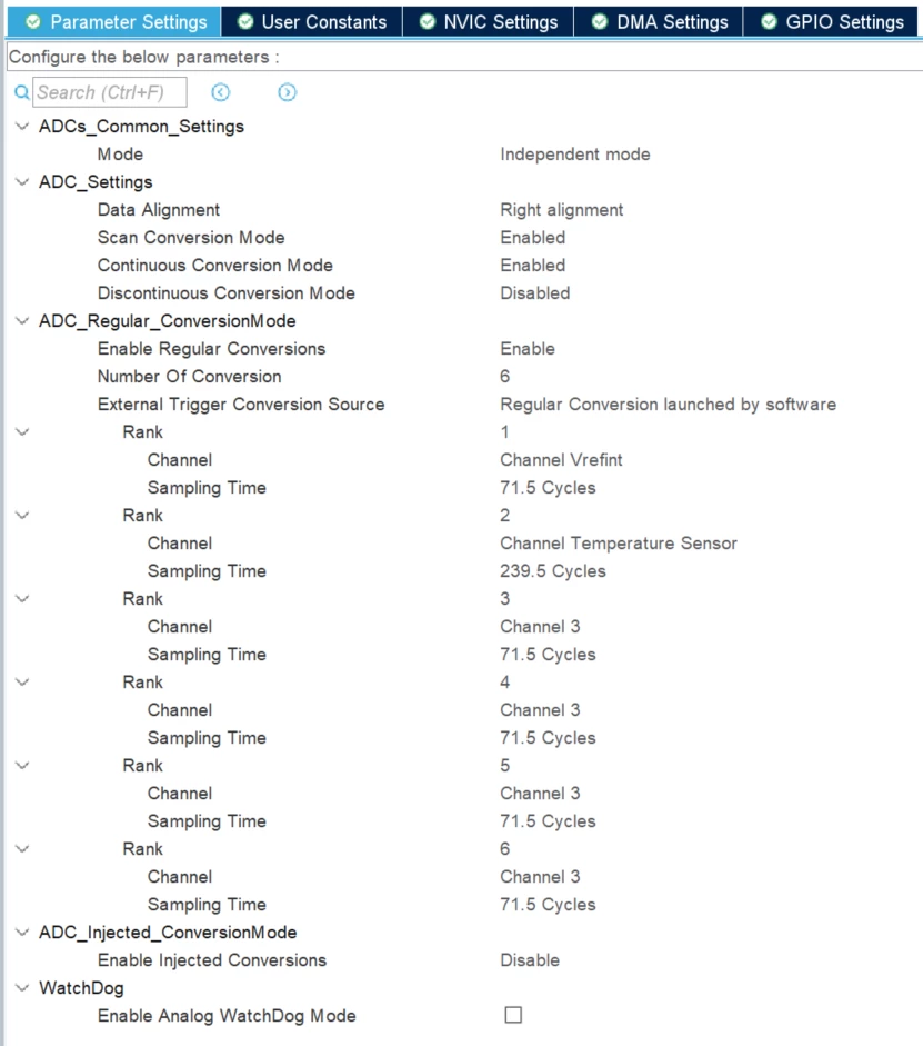

static void MX_ADC1_Init(void)
 ADC_ChannelConfTypeDef sConfig = {0};
 hadc1.Instance = ADC1;
 hadc1.Init.ScanConvMode = ADC_SCAN_ENABLE;
 hadc1.Init.ContinuousConvMode = ENABLE;
 hadc1.Init.DiscontinuousConvMode = DISABLE;
 hadc1.Init.ExternalTrigConv = ADC_SOFTWARE_START;
 hadc1.Init.DataAlign = ADC_DATAALIGN_RIGHT;
 hadc1.Init.NbrOfConversion = 6;
 if (HAL_ADC_Init(&hadc1) != HAL_OK)
 Error_Handler();
 sConfig.Channel = ADC_CHANNEL_VREFINT;
 sConfig.Rank = ADC_REGULAR_RANK_1;
 sConfig.SamplingTime = ADC_SAMPLETIME_71CYCLES_5;
 if (HAL_ADC_ConfigChannel(&hadc1, &sConfig) != HAL_OK)
 Error_Handler();
 sConfig.Channel = ADC_CHANNEL_TEMPSENSOR;
 sConfig.Rank = ADC_REGULAR_RANK_2;
 sConfig.SamplingTime = ADC_SAMPLETIME_239CYCLES_5;
 Error_Handler();
 sConfig.Channel = ADC_CHANNEL_3;
 sConfig.Rank = ADC_REGULAR_RANK_3;
 Error_Handler();
 sConfig.Rank = ADC_REGULAR_RANK_4;
 Error_Handler();
 sConfig.Rank = ADC_REGULAR_RANK_5;
 Error_Handler();
 sConfig.Rank = ADC_REGULAR_RANK_6;
 Error_Handler();

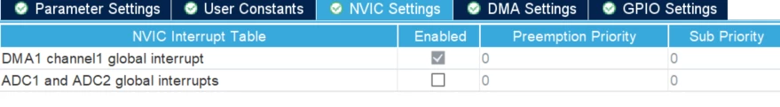

static void MX_DMA_Init(void)
 __HAL_RCC_DMA1_CLK_ENABLE();
 HAL_NVIC_SetPriority(DMA1_Channel1_IRQn, 0, 0);
 HAL_NVIC_EnableIRQ(DMA1_Channel1_IRQn);

When call HAL_ADC_Start_DMA(&hadc1, (uint32_t *)convertedData, 2), It complets a conversion every 3 seconds:
tick = 0s - Vrefint = 1185 Tmcu = 34
tick = 3s - Vrefint = 1185 Tmcu = 34
tick = 6s - Vrefint = 1185 Tmcu = 34
tick = 9s - Vrefint = 1185 Tmcu = 34
tick = 12s - Vrefint = 1185 Tmcu = 34
tick = 15s - Vrefint = 1185 Tmcu = 34
tick = 18s - Vrefint = 1185 Tmcu = 34
Is this because the ADC only calls its complete- callback function when all 6 channels complete their conversions, so it needs to be triggered 3 times(each time two channnels get triggered), and the results presented are actually correct?
When call HAL_ADC_Start_DMA(&hadc1, (uint32_t *)convertedData, 6), the ADC calls its complete- callback function every second, and gave the following result which I completely don't have any clue:

Best answer by raptorhal2
The ADC is set to continuous mode, so the callback will set the dmaTransfer status very very frequently.
Disable continuous mode to regain control of what is happening.

First, you need to describe what do you want to achieve as the issue is not clear.
Second, you can share your project including the ioc file so community members can help you efficiently.
ChaoAuthor
Senior
March 23, 2024
What I want to achieve is to get the ADC conversion result once every second by triggering the ADC once each second. The conversion results of all 6 channels are collected when DMA transfer completes (except for the Vrefint channel and temp sensor channel, other 4 channels are not connected to any signals in the test). I don't get the right values from convertedData[0] and convertedData[1] for the Vrefint and internal temperature.
Please see attached for the ioc file and the whole project (SimpleF103RCT6.rar).
mƎALLEm
March 23, 2024
First better to use a timer to trigger the ADC to start this sequence each 1 second and when the ADC conversion completes do what you want to do (computation etc ..)
So this is not a good way to do that:
	 if ((HAL_GetTick() - startTick) > 1000)
		 tick++;
		 startTick = HAL_GetTick();
//		 if (dmaTransferStatus == DMA_NOT_STARTED)
			 convertedData[VREFINT_CHAN] = 0;
			 convertedData[TEMP_SENSOR_CHAN] = 0;
			 HAL_ADC_Start_DMA(&hadc1, (uint32_t *)convertedData, 2);
			 dmaTransferStatus = DMA_NOT_COMPLETED;
Second see this thread, I've already posted a project working with STM32L152 device. The ADC is triggered by TIM2 and a sequence of 3 channel conversions is performed.
