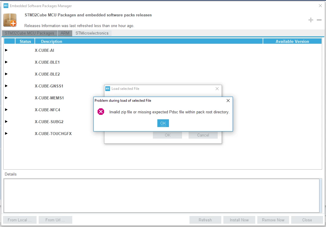

How install NFC5 package? not able to install
Hi, I am running STM32CubeMX 5.5.0 (newest)
And downloaded the NFC5 2.0 expansion package from ST website, but when I try to install it in Cube it give me this error:
How do I do to install it?
I just got one NFC05A1 board to evaluate but got stuck in this problem

So, I got an answer from ST, this package is not intended to be "installed" to the CubeMX code generation tool, it should be used as a software library manually integrated into your project.
