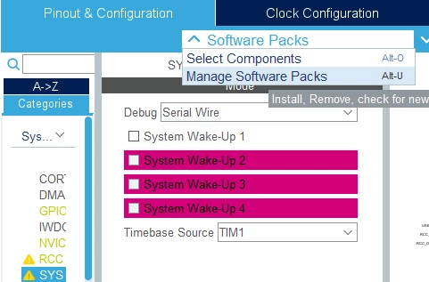

How do you install X-CUBE-Azure STM32Cube extension pack?
I am trying to install the X-CuBE-Azure expansion for STM32Cube. See expansion packages page: https://my.st.com/content/my_st_com/en/products/embedded-software/mcu-mpu-embedded-software/stm32-embedded-software/stm32cube-expansion-packages/x-cube-azure.html

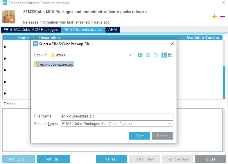

I tried to integrate it the cube by using the Manage Software Pack in the Device configuration tool:
Then I select "From local" and select the en.x-cube-azure.zip file.
I get the following error:
any ideas how to import that expansion into the cube?

X-CUBE-Azure is not a "CMSIS pack". It is not installable with CubeMX.
Just unzip the X-CUBE-Azure .zip file at root of c:\ and run the project files for the desired development environment (EWARM, MDK-ARM, STM32CubeIDE).

Thanks! it is clear now. I will probably do my own azure porting then...
