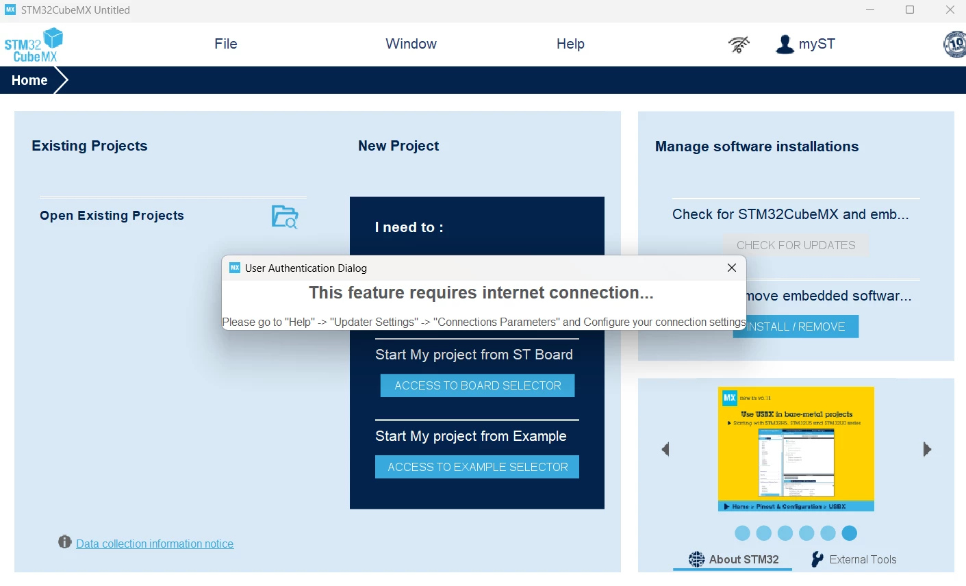

How do I login MX program?
I am a beginner.
How do I login?
I can't login MX program.
5 replies
mƎALLEm
November 18, 2024
Hello @TaehwanChoi and welcome to the community,
As shown by the message you need an internet connection to login.
Then login:
But you need first to create a profile in st.com. or click on Create Account button;

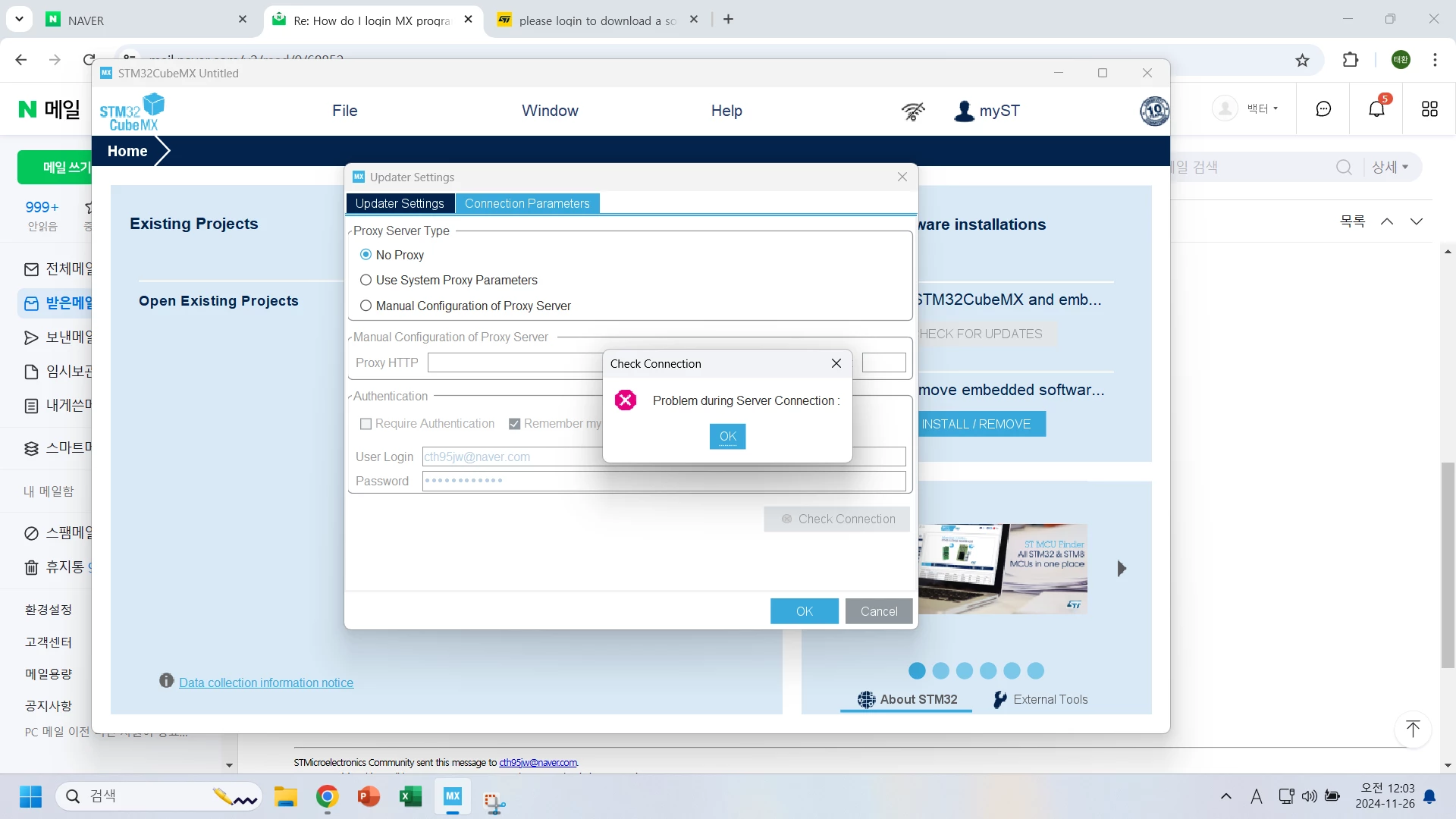

November 20, 2024
Hi. Thank you for reply.
I already have a account.
But, I can't login on MX program yet.
I think it is related to internet connection.
I am connecting to the internet by WiFi.
Just in case, Is connection-way only by Ethernet?
Sincerely,
Taehwan Choi
mƎALLEm
November 20, 2024
You can connect either with WiFi or Ethernet cable or even 4G/5G.. no matter the media is .. the most important is the internet connection.
Try to check CubeMx internet connection:
then go to Connection parameters and click on "Check Connection". You need to get a green status like shown in the following figure:
Otherwise check your proxy parameters. In that case try to select select "Use System Proxy Parameters".
November 27, 2024
Sorry I am late.
I have a problem yet.
as below picture,
I really would like to use your board(F103-RB).... I don't know why i have a problem....
