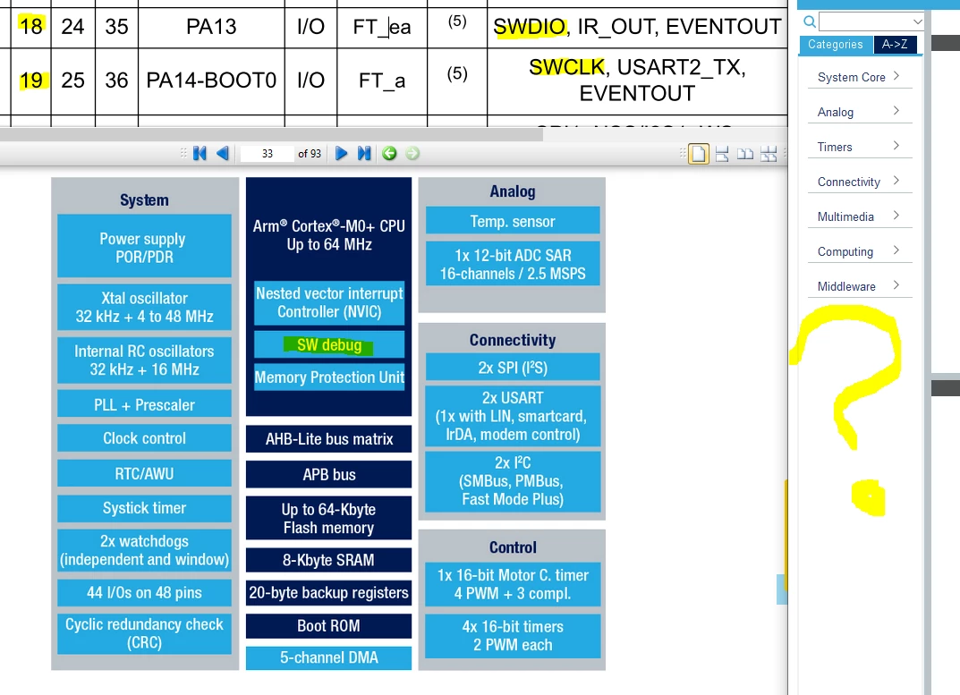

How do I enable serial wire debugging for STM32G030F6 in CubeMX?
  • November 11, 2021
  • 3 replies
  • 3869 views
0693W00000GXDi1QAH.pngThe datasheet says PA13 (SWDIO) and PA14 (SWCLK) but there is no "Trace and Debug" category in CubeMX for STM32G030F6.

KnarfB
November 11, 2021
SWDIO and SWCLK are enabled by hardware after reset, before the first CPU instruction is executed. CubeMX generates a software config that will override the pin functions soon after the CPU has started. Enabling SWD in software would be too late and could create hen/egg issues.

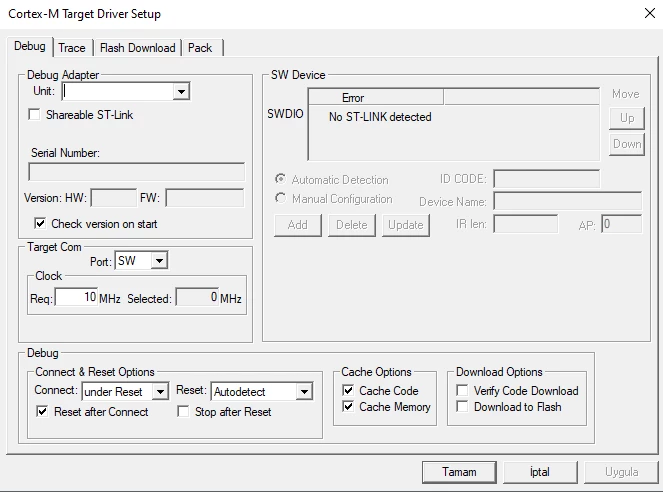

Is this configuration true?
I have chosen connect under reset and I want to debug with StLink V2.

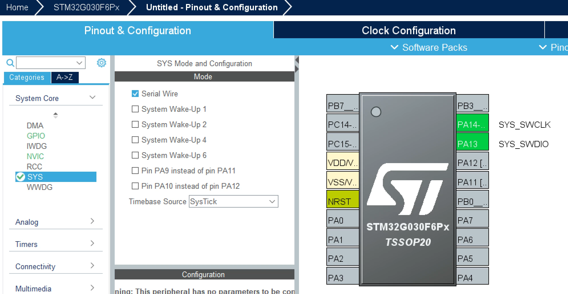

If you want the pins listed in CubeMX, you set them in System Core -> SYS -> Serial Wire.
But this doesn't actually do anything since the pins are already in those modes after reset, as KnarfB says. But it will prevent you from assigning them to different functions.
