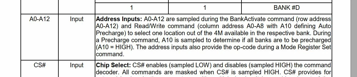

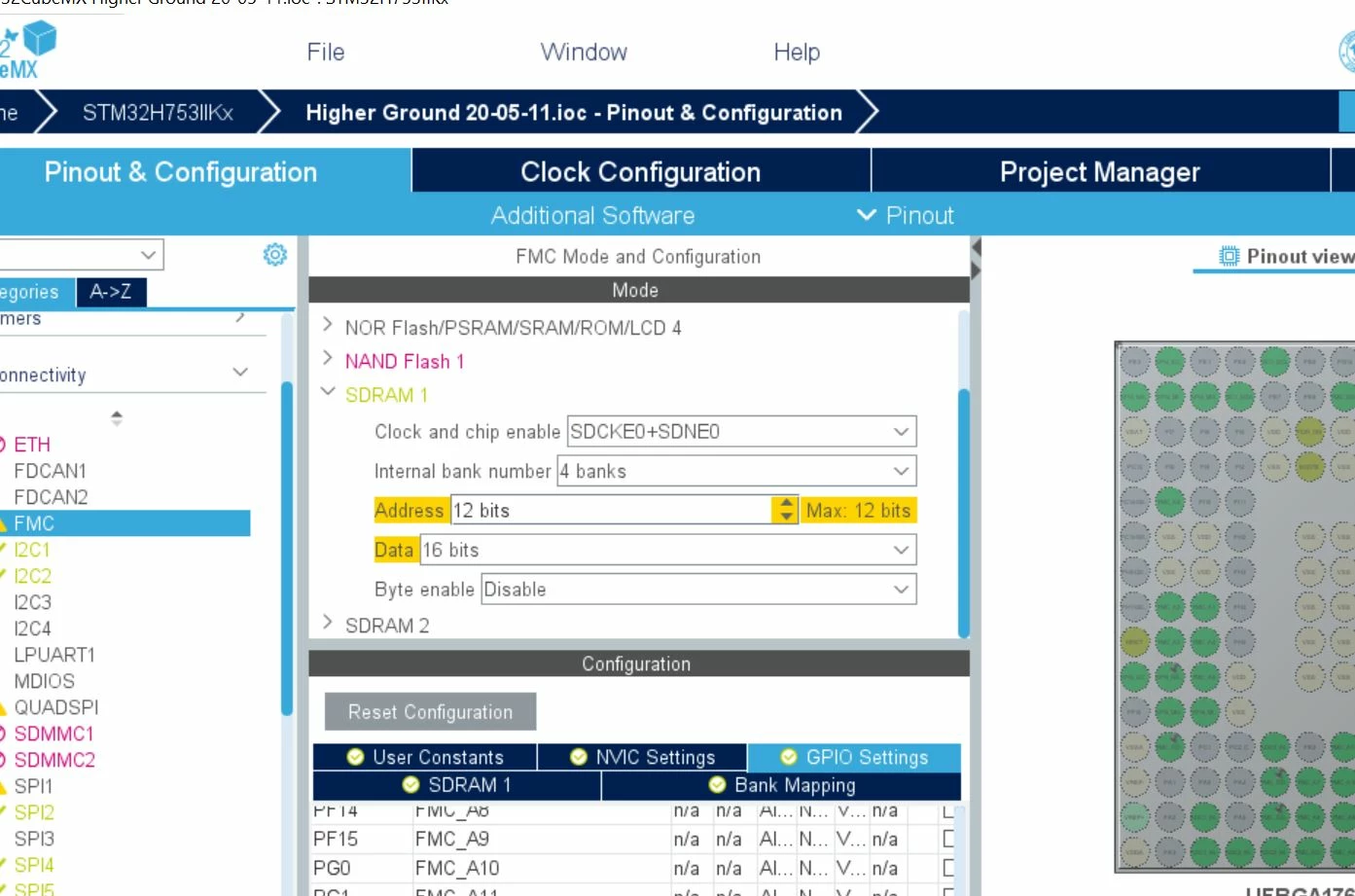

How do i assign FMC_a12 when stmcubemx limits me SDRAM to just 12 bits?
I am trying to program an STM32H7x3 device. My memory device (AS4C16M16SA) has address bits A0 - A12 and seems to need each of the 13 signals for access. However, when I go into STMCubeMX there is a max on SDRAM of 12 address bits.

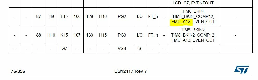

It seems like I should be able to assign the A12 address to pin PG2 based on Table8 in the DS12117 product document.
How can I override STMCubeMX to allow me to connect the full address bus?

Check PG2 isn't committed to some other function.
Worse case let it auto-gen the code, and then selectively edit it to add the pin, and address width configurations.

Good point, I can just wire to the pin and then clean up the auto-gen code. Can you confirm that will work with the FMC? I'd be worried the controller couldn't interface with the extra pin - but that doesn't really make sense because there are larger width memory chips that need 16 bit address.
The PG2 pin isn't required for anything in particular.0693W000000XECqQAO.jpg

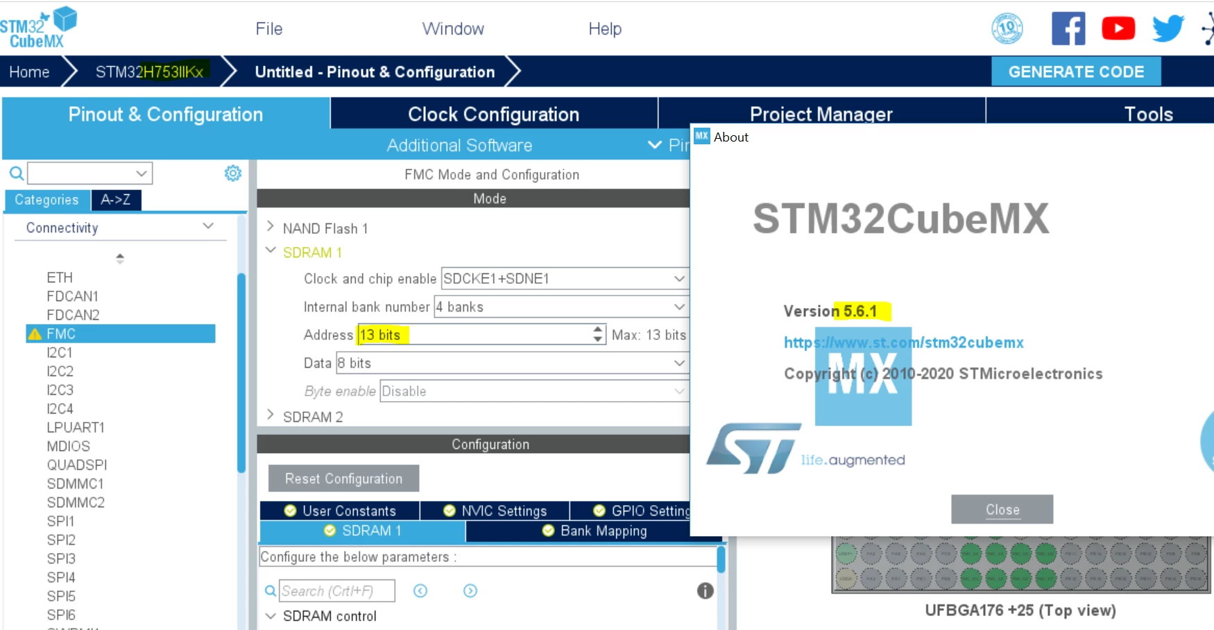

​Hello @DReis.1​ ,
Could you please check with the latest CubeMX version ? Max bits 13 on my side.
Thanks
Khouloud
