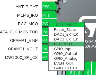

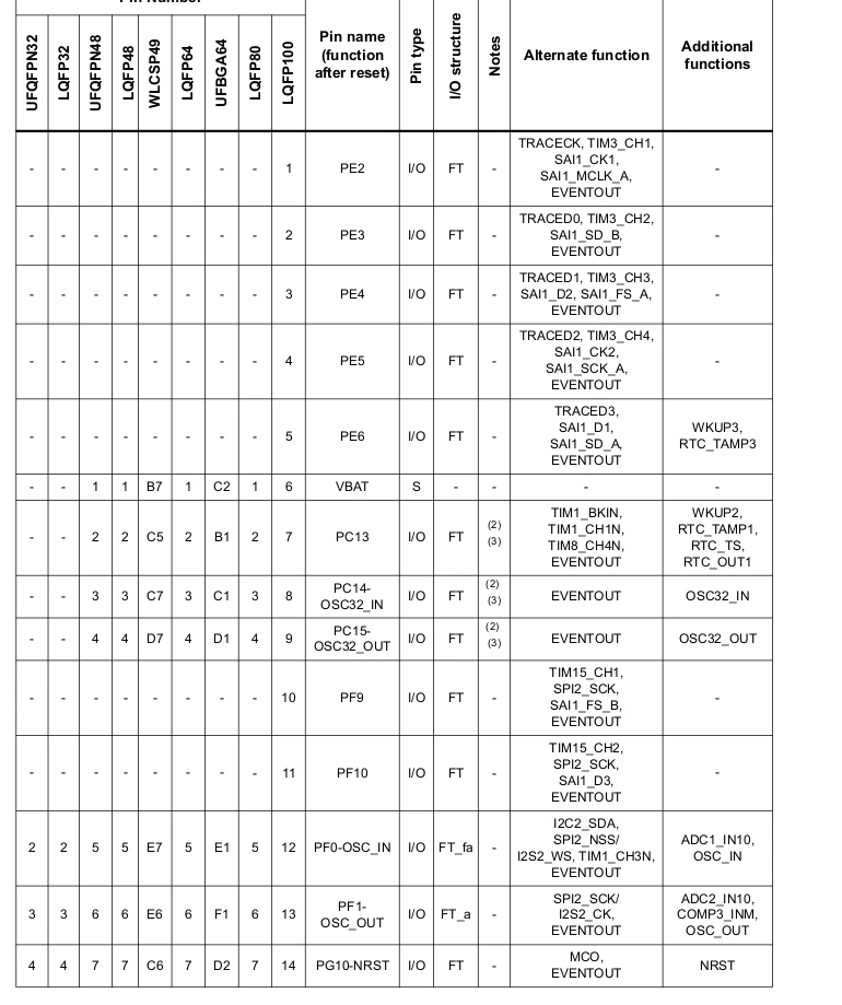

How can it be? Datasheet, as well as CubeMX allow to set alternate function (MCO) for PG10 pin (Stm32g431KBTx LQFP32) while STM's driver does not?!!!
BTW, Errata says nothing about this mess.

Interesting. I suppose the datasheet could be incorrect. The CubeMX functionality seems to be implemented off of the datasheet. I do not have a chip to test this with.
