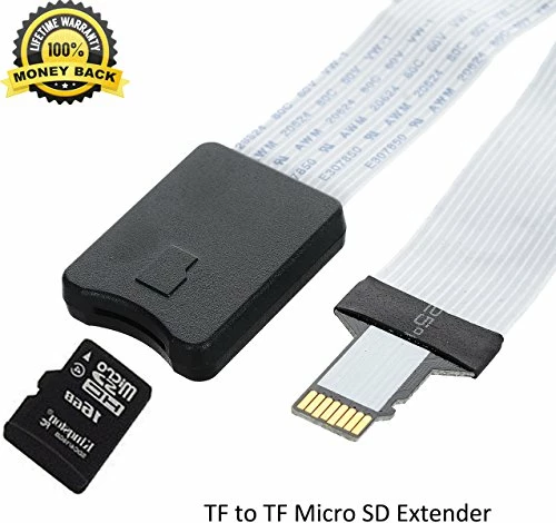

To facilitate the connection of the SD-Card I used a uSD extension so I can not use the "card dettect" pin.

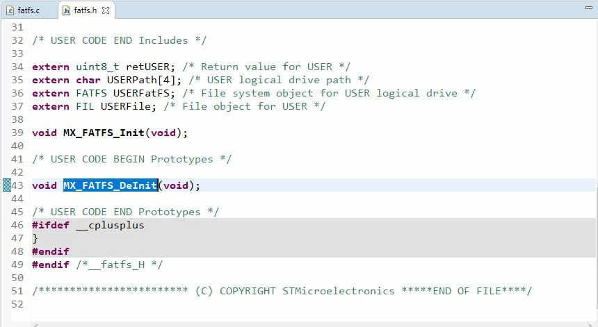

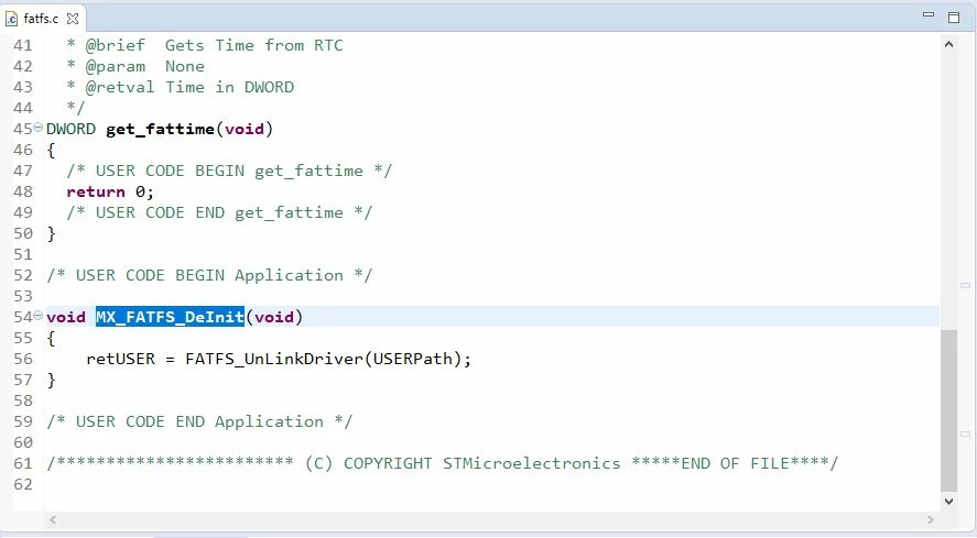

Edit the fatfs.c file with the following
And, of course, declare the function in fatfs.h

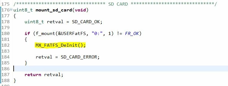

My code to mount the SD card looks something like this:
Problem solved.

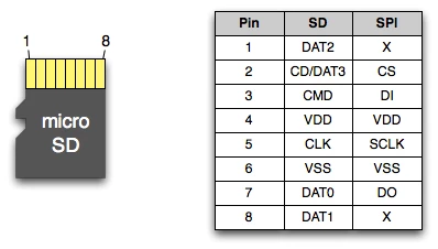

You should be able to read the pin state via GPIOC->IDR to see if a card is present, seem to recall at least one of the pins of the card should be "CD" in the SPI sense.
If I were debugging this I'd probably dig down and understand specifically which commands or functionality to the card were actually failing. At the top level FATFS the failure is far too non-specific.
The SDIO layers should have a DeInit, static structures Cube/HAL use are not cleaned post startup.
The cards themselves should have an 80 clock cycle trick to pull them out of odd states.

I do not have access to the card detect pin. The extension is always placed in the socket.
You'll need to reparse what I said. The CARD has a pin typically usable for this purpose, not just the SOCKET one you're focusing on.
CD/CMD3

After analyse the problem, I discovered the following solution.
Problem solved.
