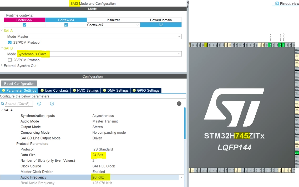

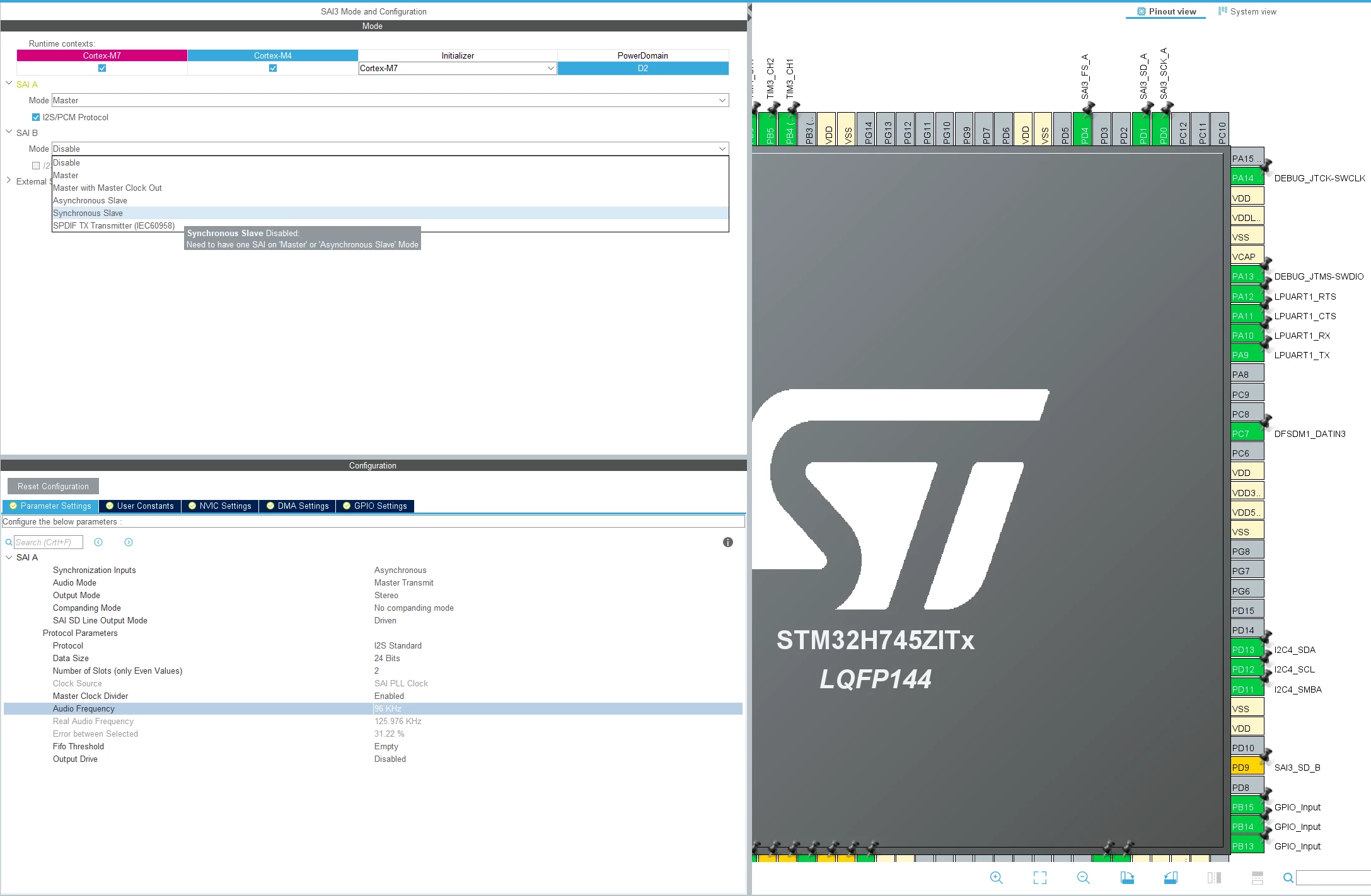

How can I get SAI internal synchronization of sub-blocks to work in CubeMX?
I'm trying to get 96kHz/24-bit I2S to work in full-duplex master mode. I select SAI 3A to be master, but "synchronous slave" is grayed out on SAI 3B. Is there something I'm missing in the settings to get it synchronize with sub-block A? I'm using a STM32H745ZI. The changelog says this problem was supposedly fixed in v5.2.0, so I'm not sure why I'm having this problem.

​Hello @DSchr.80​ ,
Thank you for your feedback, issue has been fixed in the 5.4.0 CubeMX version.

DSchr.80
DSchr.80Author
Oct 14, 2019 7:46 PM UTC
Is there a way I can update to 5.4.0 now? If not, when does ST expect to roll out this update?
Khouloud ZEMMELI
Oct 15, 2019 7:06 AM UTC
​5.4.0 version will be available to download this week.
