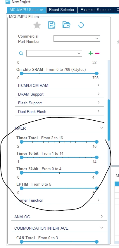

Search fot number of TIMers,
0693W00000YAsqqQAD.pngSo it would boil down to series F1 F4 and F7

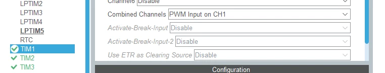

Javier,
Yes, I'm using the "Combined Channels" feature which allows the channel 1 input capture to measure the signal period and channel 2 to measure the pulse width (on time). This has worked well in combination with DMA.
0693W00000YAsmMQAT.pngI will look into the ADC suggestion :)
