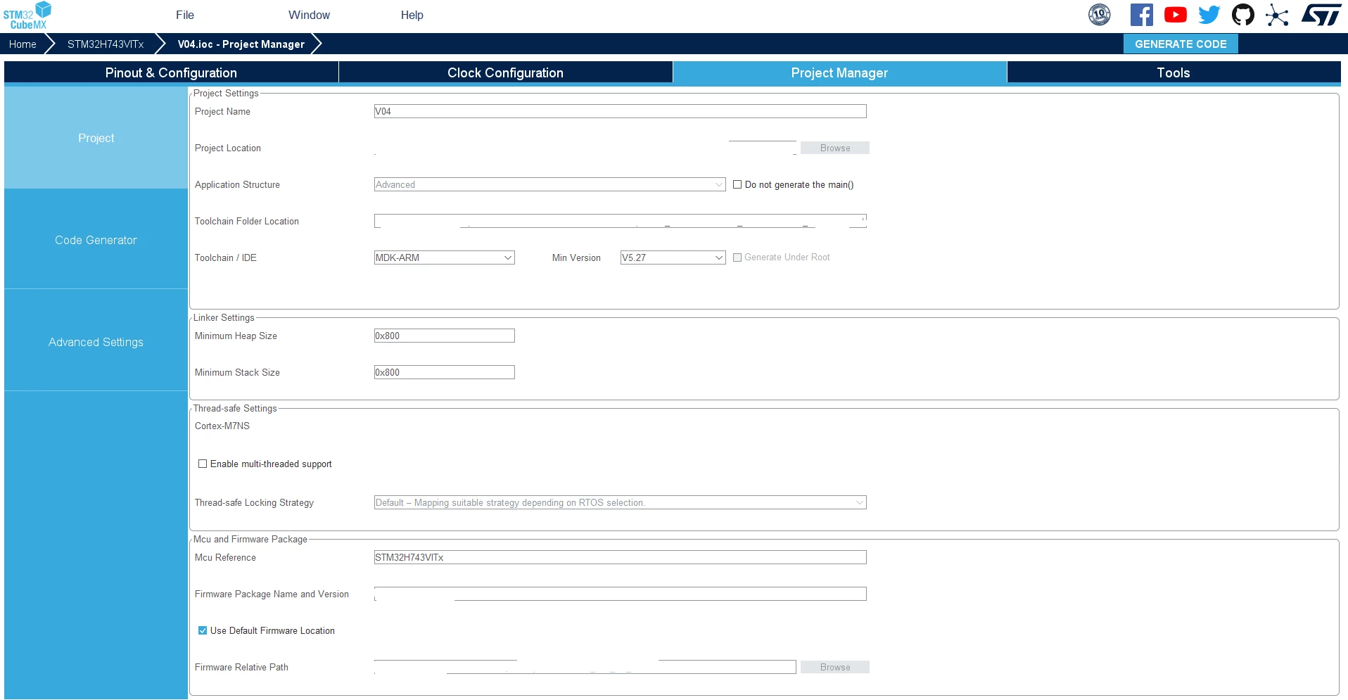

I have an issue, I can't change the project in STM32CubeMX. I wrote the project name V04 at the beginning of the project now I would like to change how can I do it. I don't touch even the textbox.

Open the .ioc in a (decent) text editor and edit the line:
ProjectManager.ProjectName=...
