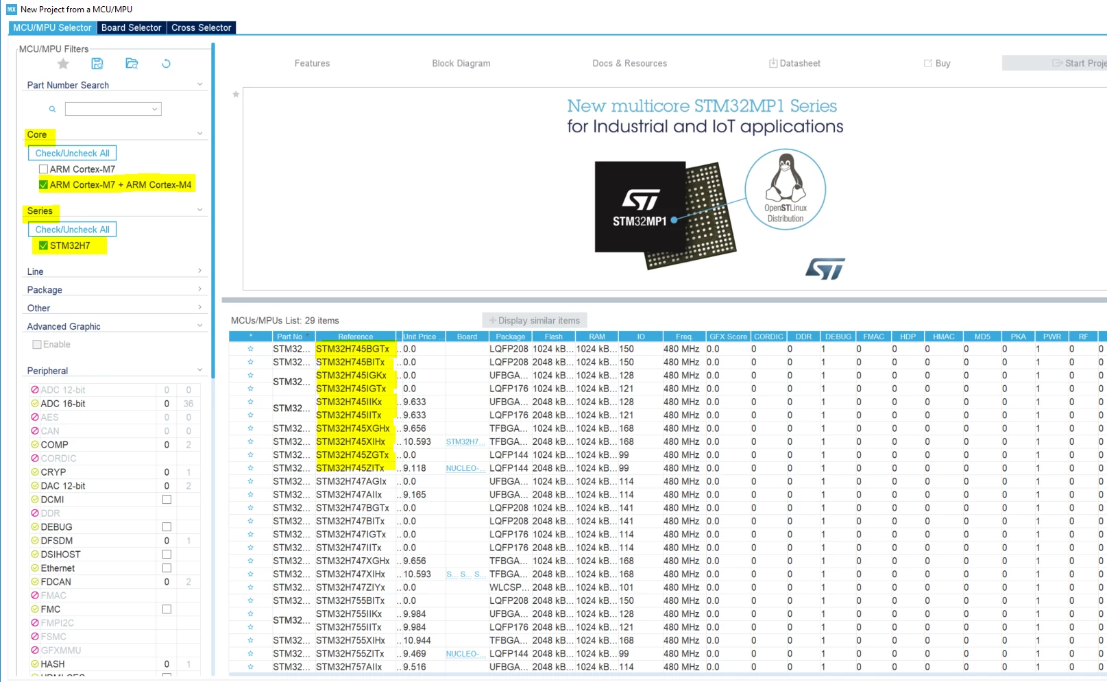

Khouloud ZEMMELI
June 24, 2019
​Open CubeMX - Select " Access to MCU selector" then:
