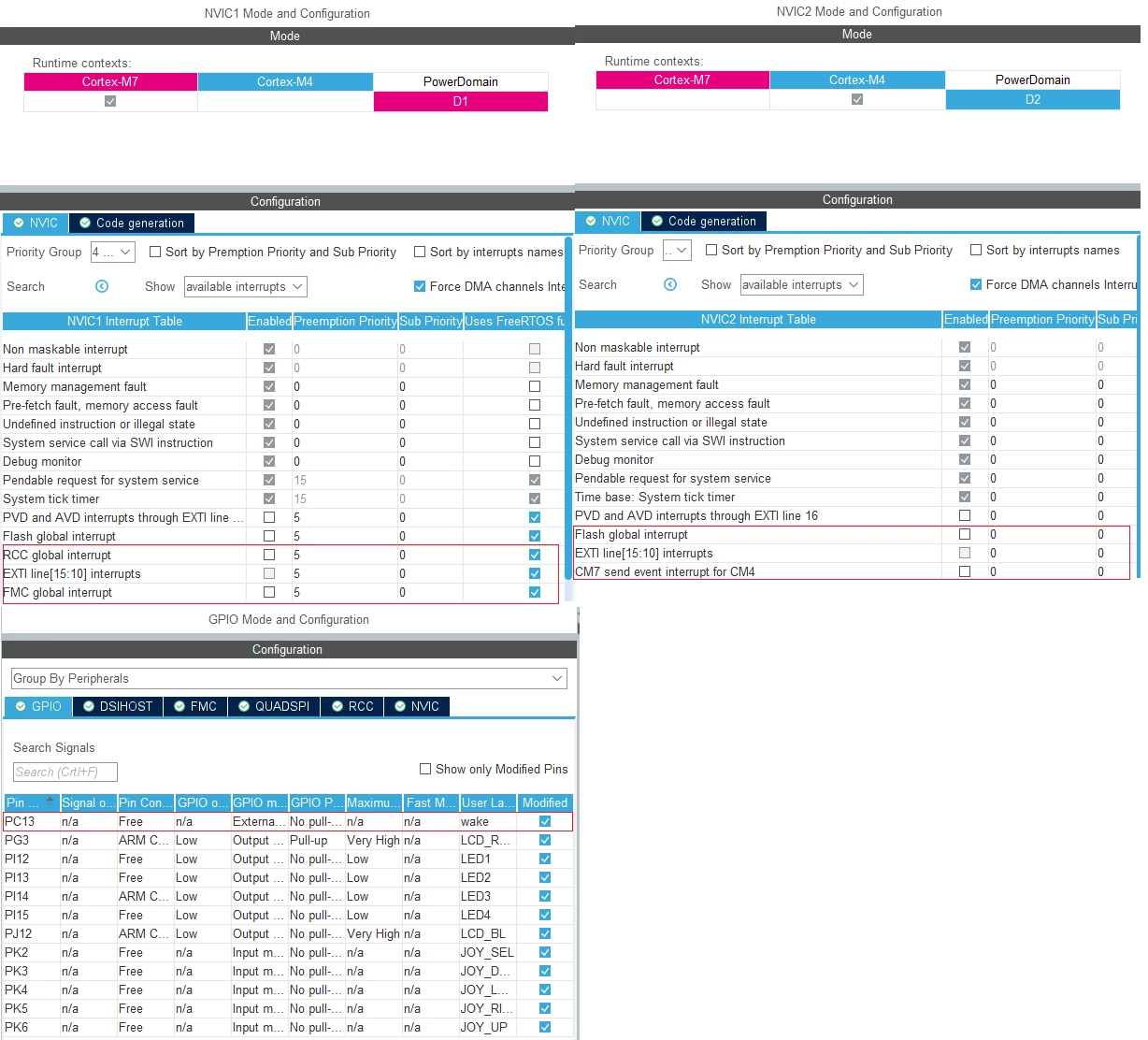

As @TDK​ mentioned: hovering the disabled box shows The corresponding GPIO pin is left as "Free" and ....
So you need to assign the pin context to the Cortex-M7. To do that:
  • open the peripheral GPIO, e.g. using the categories A->Z on the left side
  • select the GPIO in question (in your case PC13)
  • in the configuration change Pin Context Assignment from Free to ARM Cortex-M7 (NVIC1 relates to C-M7)
  • then either:
    • select tab NVIC (same page in configuration of GPIO) and tick the box at EXTI line[15:10] or
    • open the peripheral NVIC1 and tick the box at EXTI line[15:10] there
Does it answer your question?

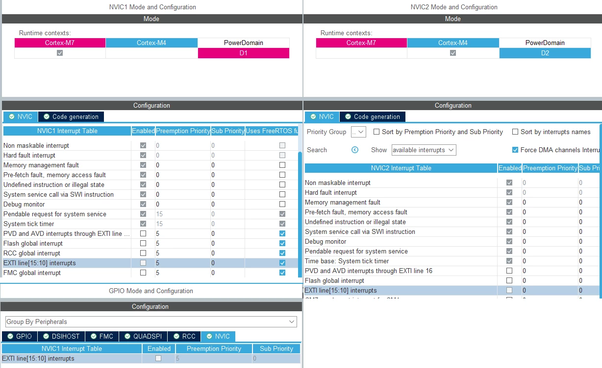

JLee.00000
Mar 3, 2022 8:10 AM UTC
I clicked on the box, but I couldn't activate it.
Can you see that the color is different from the other boxes?
I don't know why it is like this.
Mar 3, 2022 2:03 PM UTC
There's probably a reason it's disabled. Hover over it and see if a note pops up. If that's not it, attach the IOC.

I saw a popup hover over it
that talk "The corresponding GPIO pin is left as "Free" and not used by any middleware or pack."
Thanks to you, I was able to solve the problem.
Bob S
Mar 3, 2022 2:45 PM UTC
Disclaimer: I have no direct experience with dual-core STM32 CPUs, but... Do you need to map that EXTI pin to one of the cores first?

JLee.00000
Mar 4, 2022 1:46 AM UTC
I solved the problem by following your instructions.
