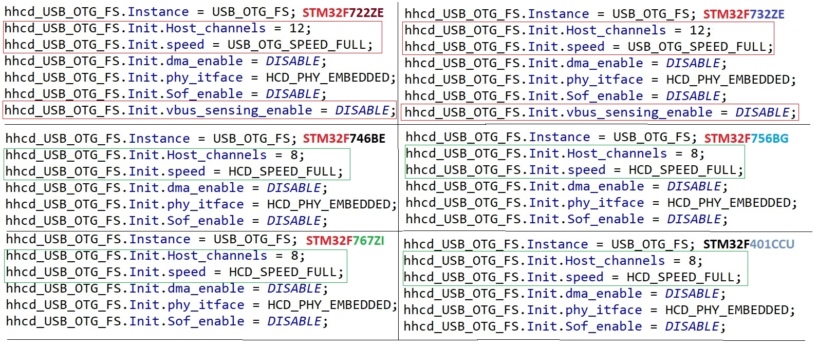

MMARI.1
Senior II
May 1, 2024 8:26 AM UTC
hi ..
any solution  on ticket number  for usb issue ? . i  am having similar issue like below
https://community.st.com/t5/stm32-mcus-products/serious-bug-in-usb-keyboard-stm32f722ze-nucleo-board/m-p/667122#M242306
problem is very much visible
Speed setting different  & channels number is different :
Cube ide Generating additional code line  for STMF722ZE & STM32F732ZE ( complete STMF72XXXXX series STMF73XXXX )
additional code line:
Cube ide Generating code without additional above mentioned line  for STMF746XX,STM32F756XX &STM32F767XX & STM32F401XXXXseries .
code generation must be only issue .
