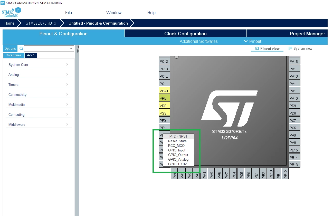

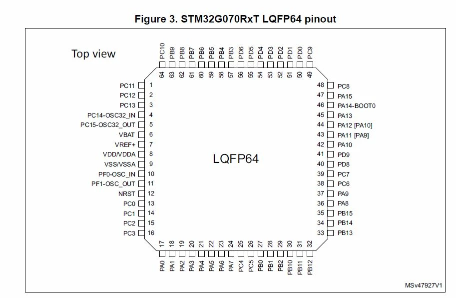

Igor Shirokov
Mar 22, 2019 8:15 PM UTC
Hi. I want to configure pin 12 on STM32G070RxT. On DataSheet from ST it is called "NRST", but in STM32CubeMX, this pin is called "PF2". Where information is right?

S.Ma
Principal
Mar 23, 2019 10:03 AM UTC
Official information should be product datasheet and its errata.

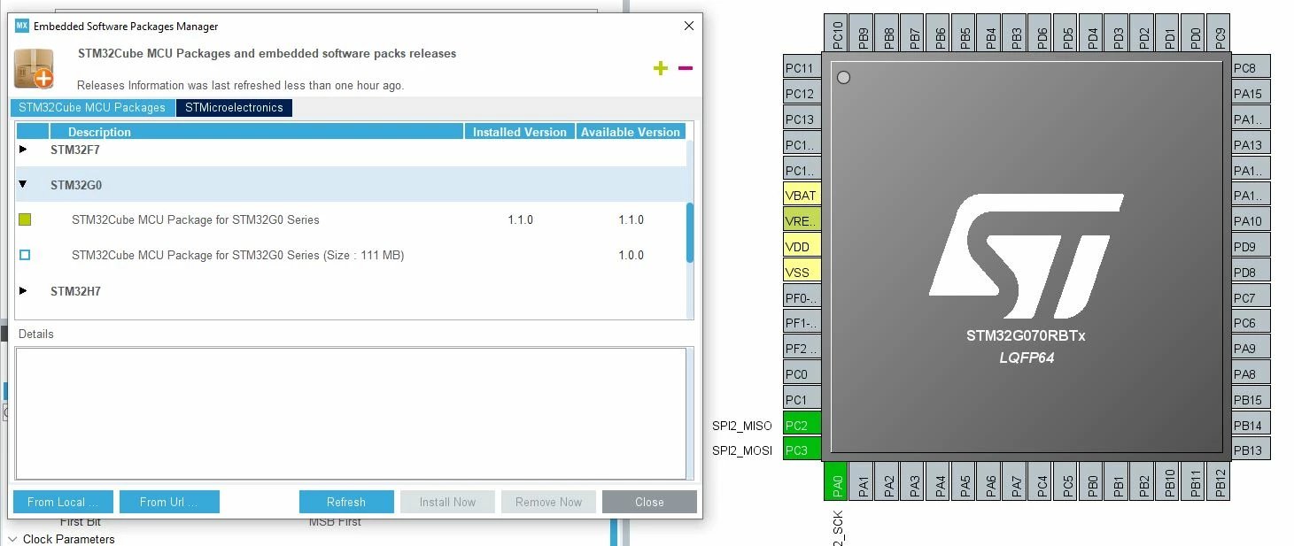

Khouloud ZEMMELI
Mar 25, 2019 7:49 AM UTC
Pin 12 on CubeMX :

Khouloud ZEMMELI
Mar 25, 2019 3:39 PM UTC
​@Community member​
This is a CubeMX issue and it will be fixed in next release.
