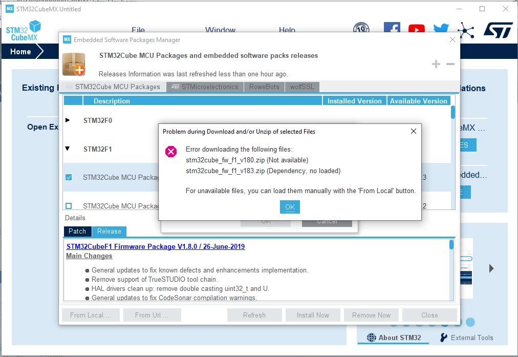

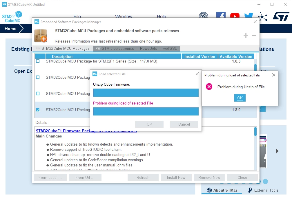

hi, i'm trying to install a STMcube package MCU, STM32f1 package, when i click on "install now" this happen then, when i try to make it "from local" appears
i'm have version 6.2.0
i'm trying to install stm32cube MCU package for STM32F! version 1.8.3 or 1.8.0

to install the patch (1.83) previous version must already be installed (1.80).
1.83 isn't a fullpack.

go to this link to download the package in zip form. After use it from CubeMX as "from local"
EGóme.1
EGóme.1Author
Apr 17, 2021 10:39 PM UTC
i already did it, but the problem keeps showing :(
