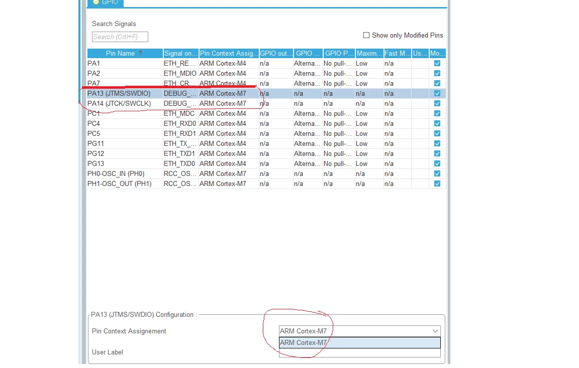

Hi , I find the H757XIHx EVB can not debug . I generated the project from CubeMX . In CubeMX , I select the Debug model serial Wire ,but It can only attach to the Cortex-M7,so it can not debug M4 core. What should I do ? Thank you very much!

Hello @FWANG.1​
Could you please share your ioc file to check the issue.

Hi Nesrine,
Thanks for your support!
I have solved this problem ,that is not the Cube's problem.
I updata the STLink driver and solved this issue.
I can debug both core now.
