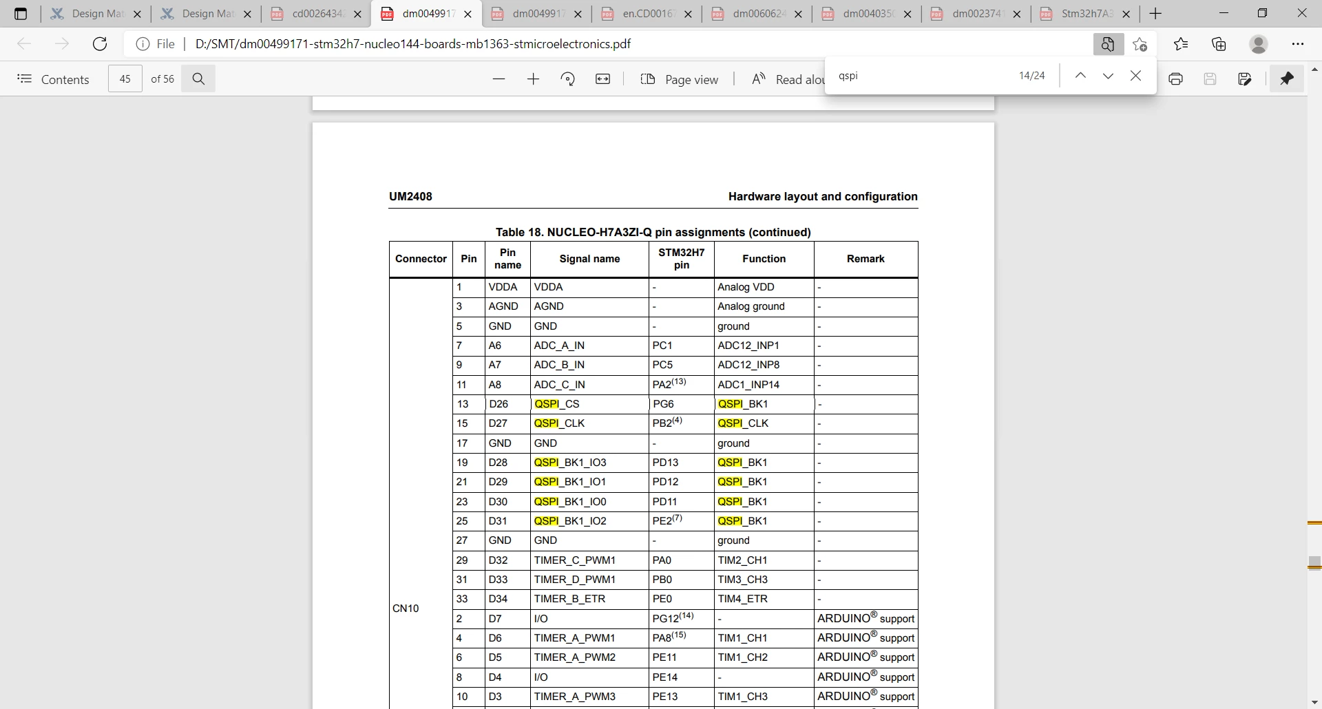

Hi, I am using STM32H7A3 board. I need to store a large file. My requirement is to connect an external Flash to STM32 board. When i checked the documents i found QSPI support external flash memory.
The QSPI pins are mentioned in STM32H7A3 reference document. Please refer Img1.

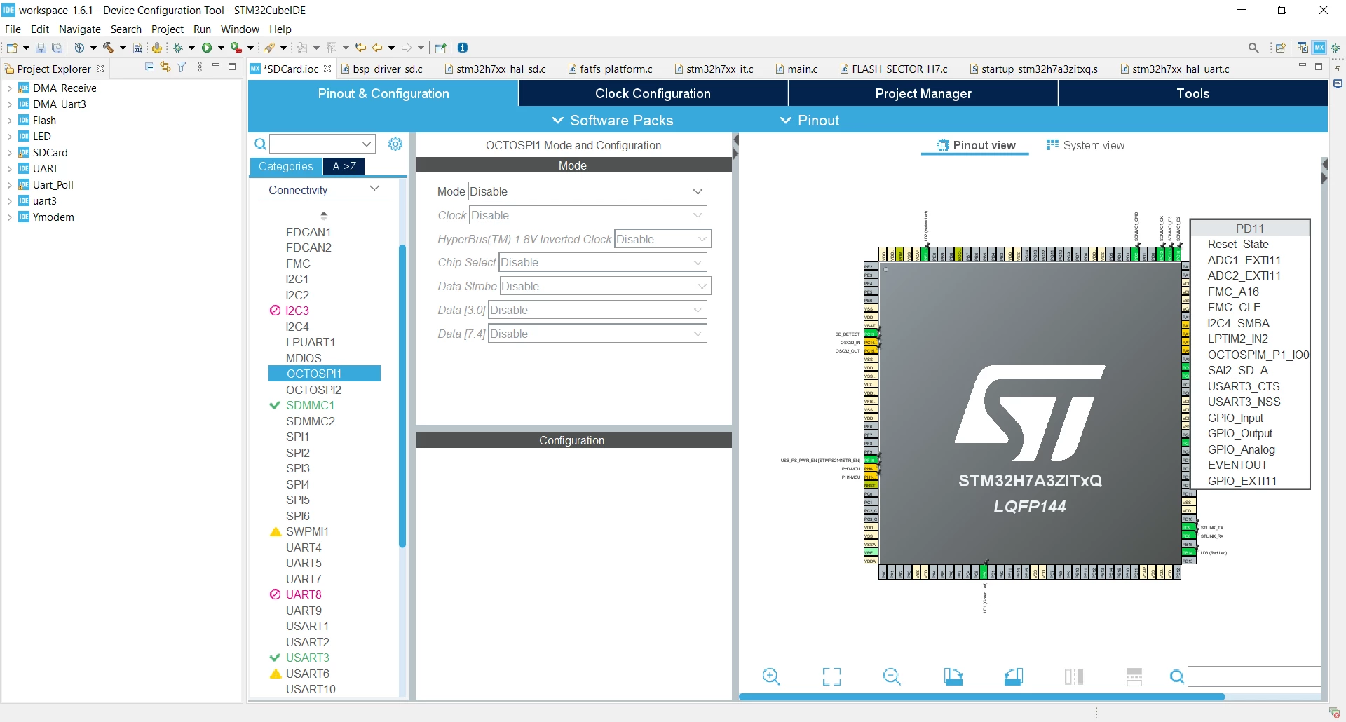

In STM32CubeIDE I am seeing the interface as OCTOSPI. Please refer Img2.

In STM32H7A3 datasheet - QSPI pins are mentioned( refer Img1).
But in STM32CubeIDE , under connectivity tab- I am able to see OCTOSPI1 and 2 . (Refer Img2)
Which peripheral is supported by my device?
How can i configure it correctly as it is showing difference between datasheet and Cube IDE?

You'd use OCTOSPI in 4-bit only mode, or figure what additional pins on the H7A3 or Nucleo are exposed to get access to D4..D7
The OCTOSPI is a super-set of the older QUADSPI peripheral.

So i need to configure OCTOSPI in 4-bit only mode and assign the pins to - D0 to D3 and CS and CLK as given in the H7A3 datasheet QSPI pins( Img1), right?
