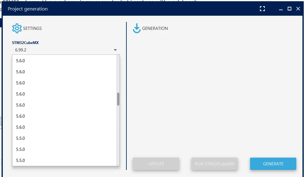

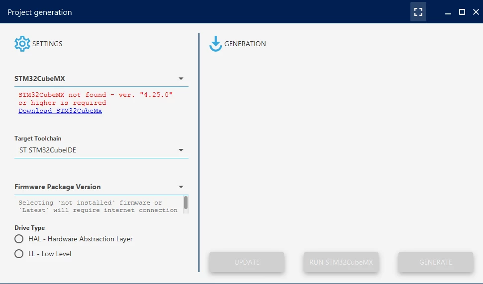

Hi, I am trying to use motor control work bench with STM32cubemx. I have cubemx in my computer but i cant use with work bench and i am receiving errror which is ' STM32Cubemx not found'. Also i tried with all STMCubemx versions. How can i fix this?

Which STM32cubeMX version do you use ?
I tried it now, i had no problem.

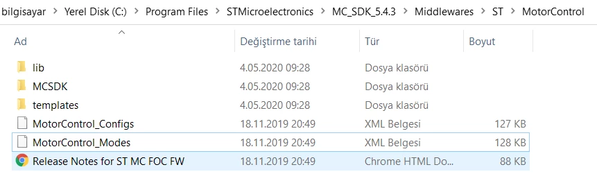

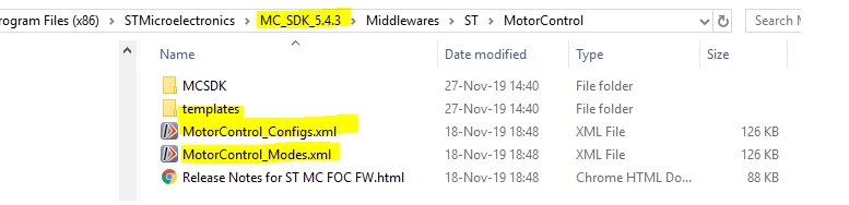

Please try with this steps:
You already need a well-named directory in the STM32Cube repository :
Generally speaking: MCSDK_vX.Y.Z..
In this directory, you will have to copy the MotorControl directory found in the MCSDK installation:
and have the following content in the tree structure:
Best regards,
Nesrine

Hi @Nesrine.JLASSI​ , First of all thank you for attention. I am using CubeMx version 5.6. And i tried this steps but probably i have problem about XML file.0693W000000X2xLQAS.png

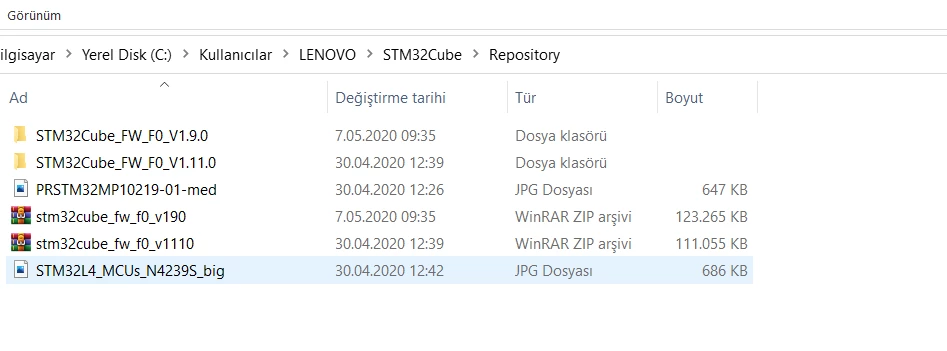

As nesrine already stated: You NEED that directory (as described), then you have to copy the MotorControl directory found in the MCSDK installation. Inside you should have the described content then… Read the instructions again (and carefully ;) )

Thank you for attention i fixed my problem. My problem derives from the my computer language. When i changed my computer language Turkish to English problem solved to. ;)
