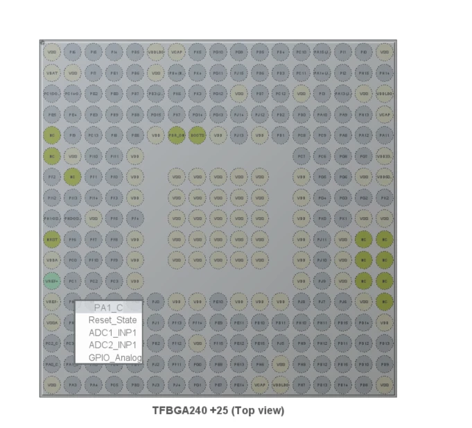

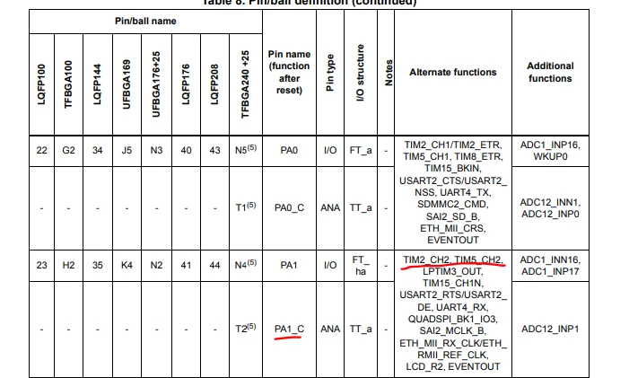

Hi I am concerned about the following microcontroller : STM32H753XIH6TR When using cube Mx to configure the timers on pin PA1_C the options specified in the data sheet are not avaliable. How do I access these functions?
Please see attatched image of functions specified in datasheet.
Please see image attatched of functions avalailable on cube MX
Thanks for your help !

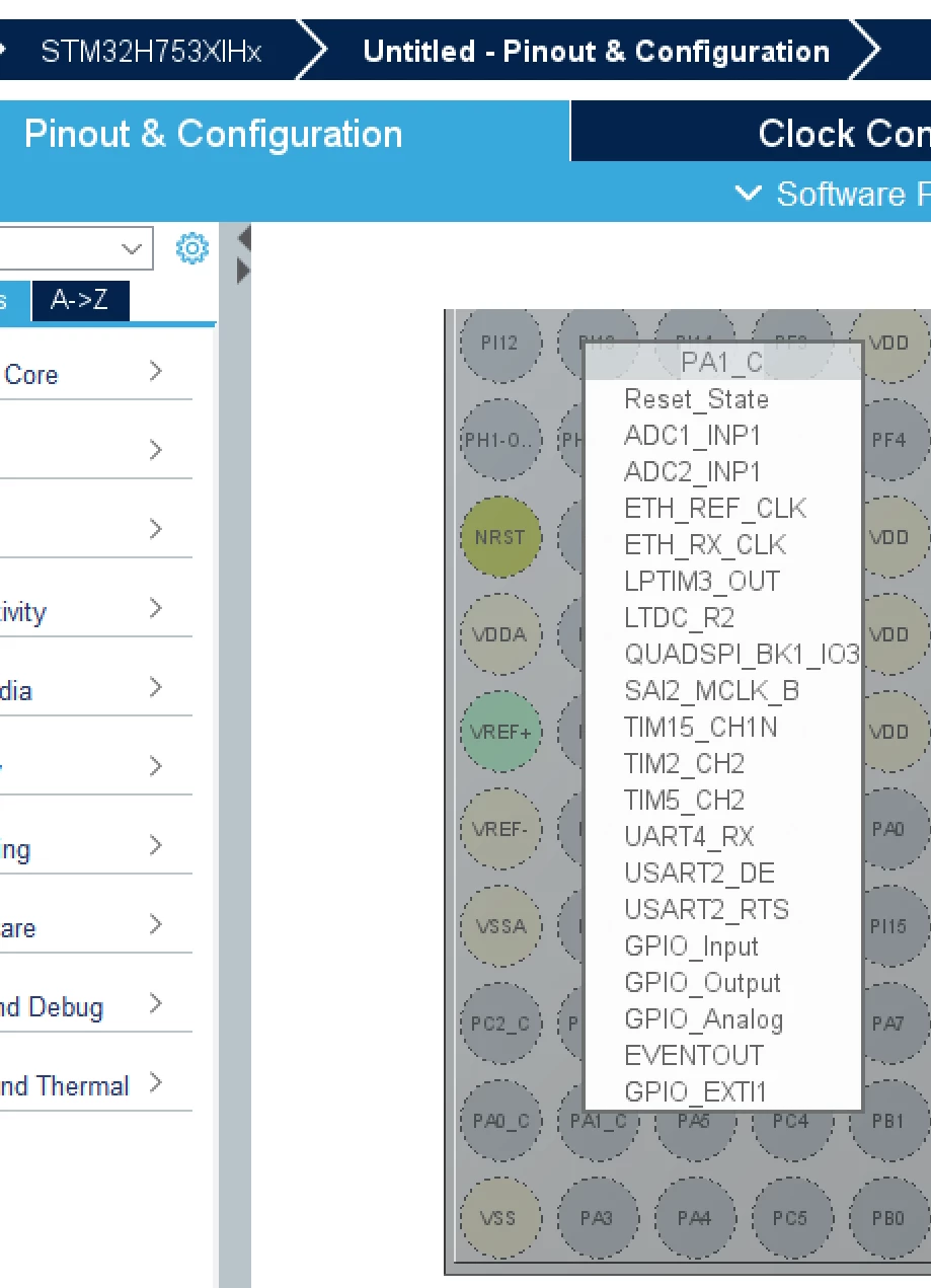

No such issues here. Brand new project:
CubeMX v6.3.0
STM32Cube FW_H7 V1.9.0
11 replies
TDKBest answer
Aug 11, 2021 2:15 PM UTC
CubeMX v6.3.0

Aug 11, 2021 2:25 PM UTC
Attach your IOC.
LMyle.1
LMyle.1Author
Aug 11, 2021 2:35 PM UTC
Sorry couldnt find IOC file ?
LMyle.1
LMyle.1Author
Aug 11, 2021 2:39 PM UTC
please see report attatched thanks for your time

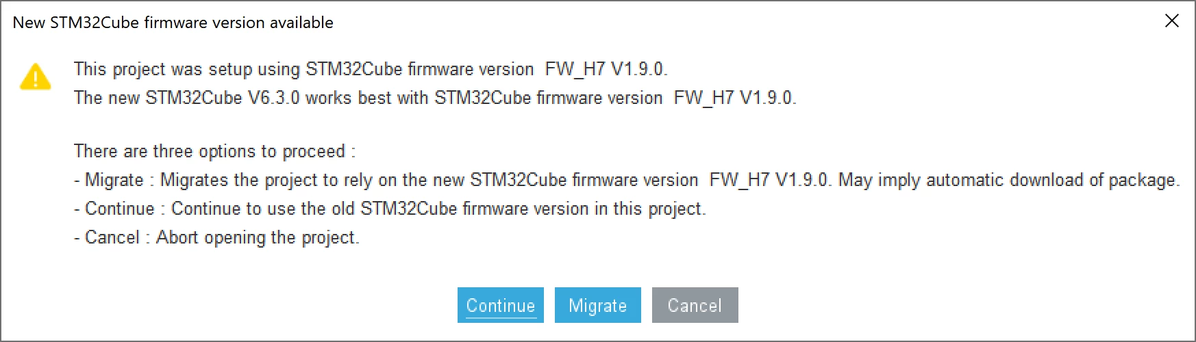

Aug 11, 2021 2:45 PM UTC
When opening your file, I got a bizarre message wanting me to migrate to the latest version, even though the name was the same.
0693W00000D2BlsQAF.pngAnyhow, I did so and was able to select all the functions shown in my post.
I suggest trying to download the newest H7 package and migrating to that. (Help -> Manage embedded...)
