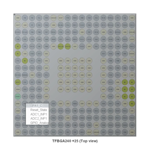

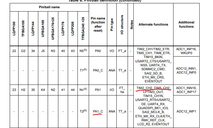

Hi I am concerned about the following microcontroller : STM32H753XIH6TR When using cube Mx to configure the timers on pin PA1_C the options specified in the data sheet are not avaliable. How do I access these functions?
I have downloaded the new H7 package as previously suggested and the issue still remains.
Please see attatched image of functions specified in datasheet.
Please see image attatched of functions avalailable on cube MX
Thanks for your help !

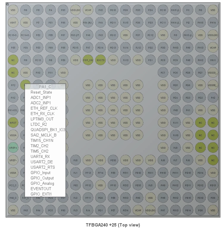

I can confirm this problem for your versions on Windows and that it has already been fixed.
Please upgrade to the most recent versions of STM32CubeMX and/or STM32CubeIDE.

Peter BENSCH
Aug 12, 2021 9:08 AM UTC
Looks like a problem displaying the full list of functions.
Where does this problem occur (CubeMX, CubeIDE), with which version and on which platform?
Usually it looks like this:
0693W00000D2FsEQAV.pngRegard

LMyle.1
LMyle.1Author
Aug 12, 2021 9:20 AM UTC
In both CUBE MX and IDE version of cube mx : 6.2.0
software package:1.9.0
Cube IDE: 1.6.1
My colleague is having the same issue. Thanks
