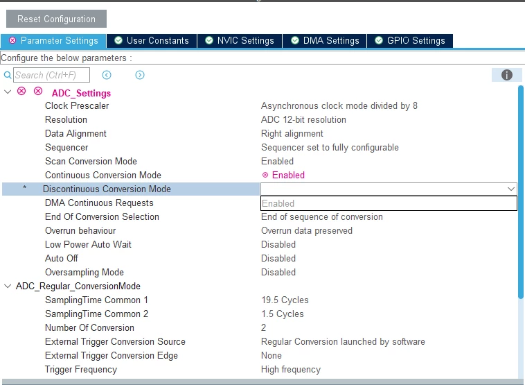

Hi, does anyone khnow why I can't set Continuous Conversion Mode to "Enable"? (I also use DMA with ADC)

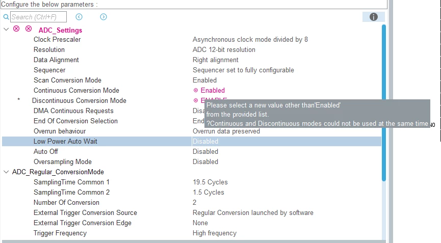

doesnt it tell you aything helpful when you hover the mouse?

It only tell that continuous mode and discontinuous mode can not be used at this same time (which is logical) however I can not change "Discontinuous Mode" to disable

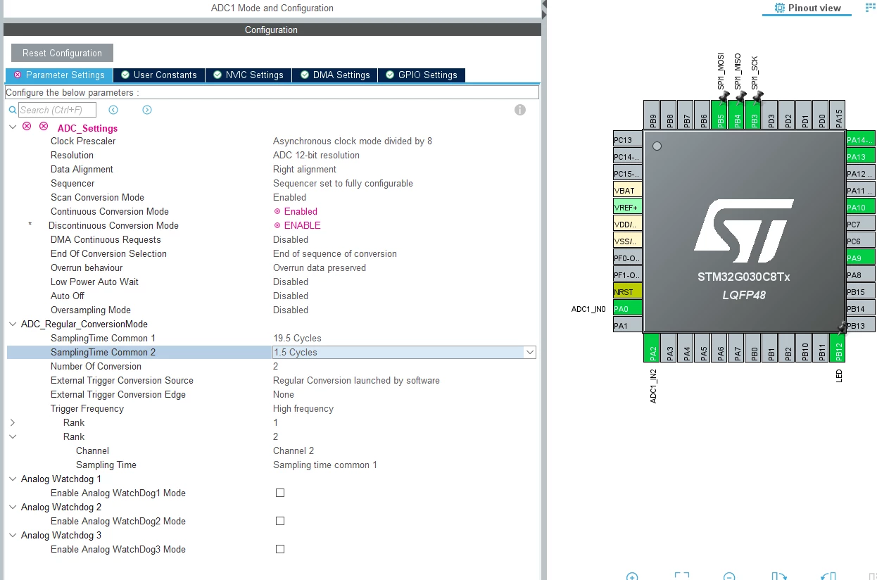

Could you share your cubeMX file with us?

i opened your file, indeed there is something weird in cubeMX, it forces you to do scan->Discontinuous mode, in other boards stm32f072 of mine i dont have this issue.

Hi, what version are you using? There is a bug in cubeIDE 1.9.0 for the G0. In our projects we override in the USER section of the initialisation function.
