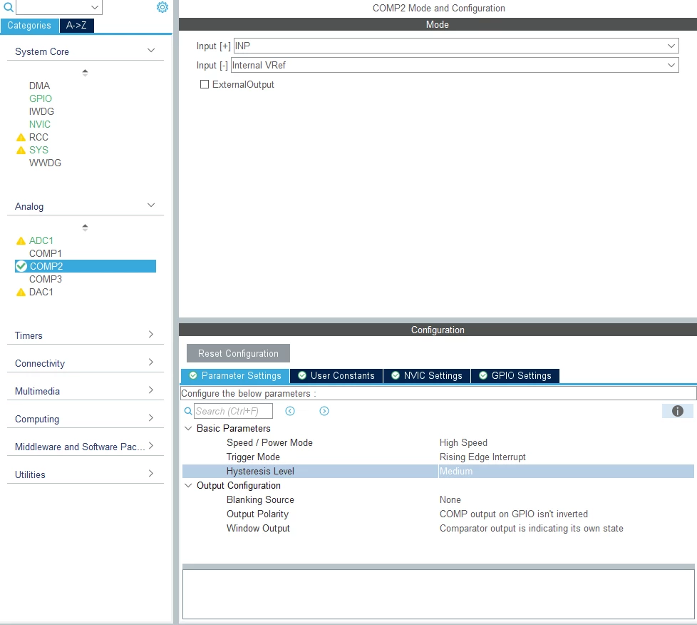

I have trouble setting up comparator on board nucleo-stm32G0b1RE. I've been following some tutorials on how to setup through stm32CubeMx, I believe I have the settings right, but I can't make the comparator work, it doesn't trigger the interrupt when I switch the input. Here is what I have so far:
in .ioc file
After code generation, I manually added the callback in main.c:
void HAL_COMP_TriggerCallback(COMP_HandleTypeDef *hcomp)
HAL_GPIO_TogglePin(GPIOA, GPIO_PIN_5);

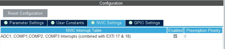

And I believe the interrupt handler was setup allright. The interrupt triggers normally for the ADC (but not for COMP):
* @brief This function handles ADC1, COMP1,COMP2, COMP3 Interrupts (combined with EXTI 17 & 18).
void ADC1_COMP_IRQHandler(void)
/* USER CODE BEGIN ADC1_COMP_IRQn 0 */
/* USER CODE END ADC1_COMP_IRQn 0 */
HAL_ADC_IRQHandler(&hadc1);
HAL_COMP_IRQHandler(&hcomp2);
/* USER CODE BEGIN ADC1_COMP_IRQn 1 */
/* USER CODE END ADC1_COMP_IRQn 1 */
