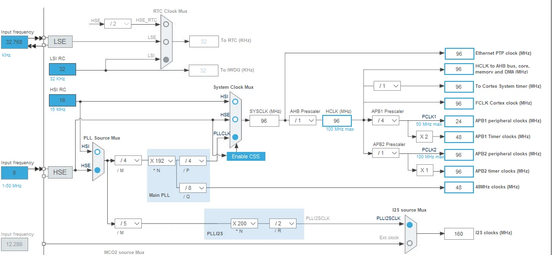

Having problems when using Cubemx to setup STM32F411 discovery board clock (system) in the default setting.
0690X000006DoGOQA0.pngI am trying to set up STM32F411 disc board with Cubemx, the clock tree is set up as default for the board by CubeMx as shown where system clock is set to 96MHz as shown. The generated code for this is contained in function SystemClock_Config(void).
There are two problems with this clock setting:
  1. In MX advanced setting, if I set RCC driver in using LL library. The initiating code will stuck in "while(LL_RCC_HSE_IsReady() != 1)". However if the skeleton code is generate by setting RCC to HAL the init code works fine and do not stuck in the middle. The init code generated by CubeMX is attached below. ​
  2. For the RCC code generated using HAL, although the code runs in the debug mode, the system clock and timer clock frequencies are not the same as it mean to be (96MHz/48MHz). This was tested by setting timer pre-scaler and Auto reload register and check the update event. The real frequency seem to be much slower then the expected although all the code for setting system clock is made by CubeMX. Not sure whats wrong here.

nico 2010
Dec 3, 2019 11:56 AM UTC
This:
 RCC_OscInitStruct.HSEState = RCC_HSE_BYPASS;
is wrong. STM32F411 has its own quartz (8 MHz).
So, correct it is:
RCC_OscInitStruct.HSEState = RCC_HSE_ON;
Try it.

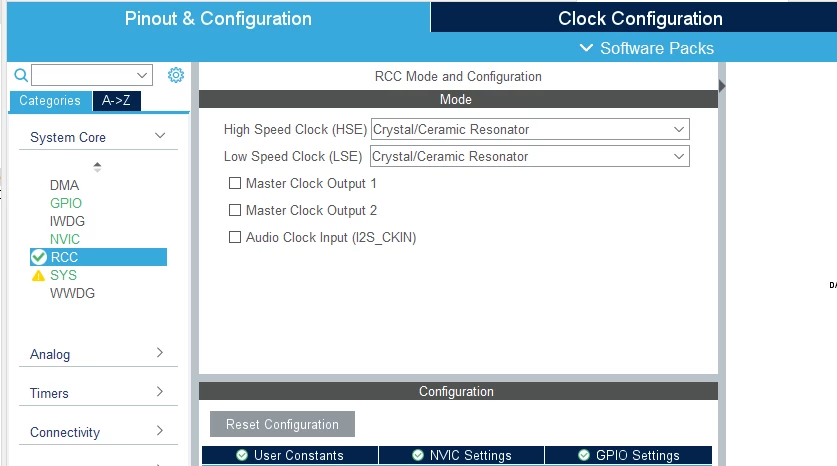

Visitor II
Oct 20, 2021 1:41 PM UTC
lordy lord lord - this is the same bug I had - even with newest IDE 1.7.1 today...
Make SURE to go to RCC and enable the HSE crystal! then both pins will be shown in the clock configuration
