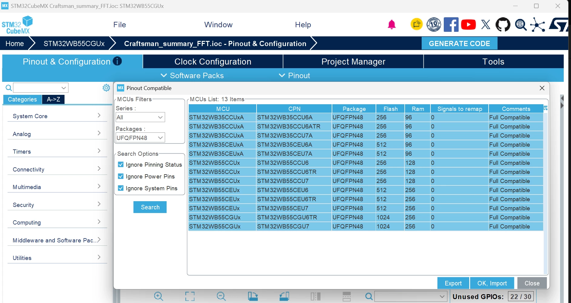

Having issue with change target MCU in MX
I have a project that was using an STM32WB55RG. I copied & pasted this project in Cube then opened up the IOC in MX & managed to retarget to an STM32WB55GC. But I now notice that the original project has also been retargeted.

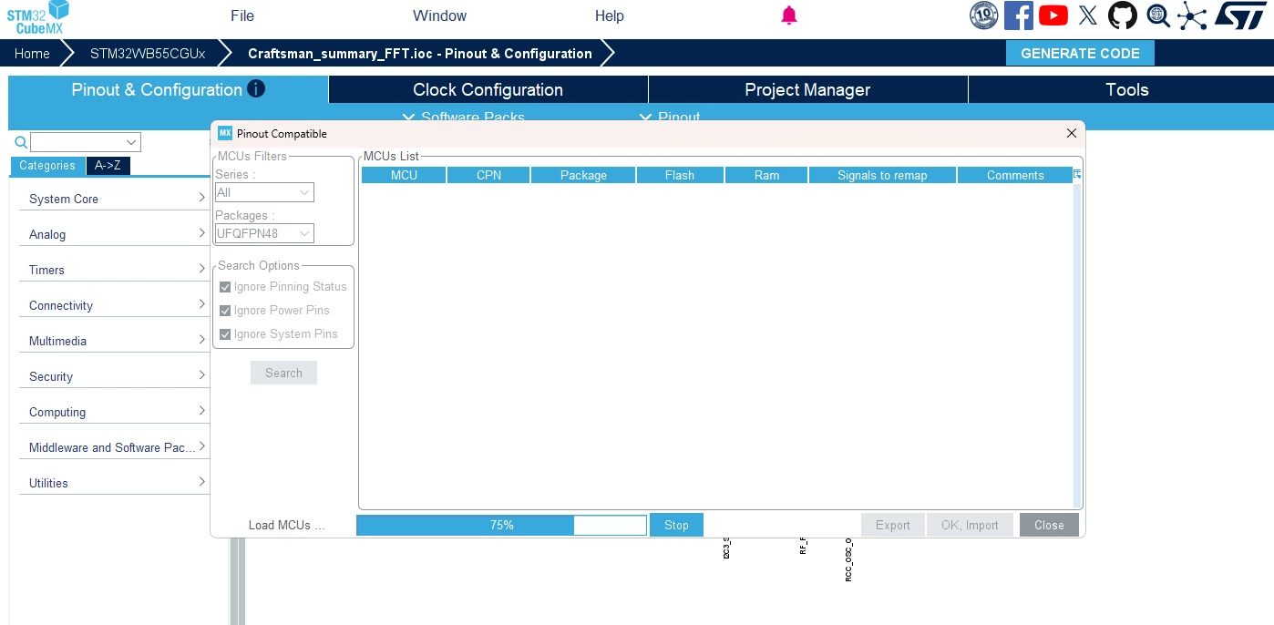

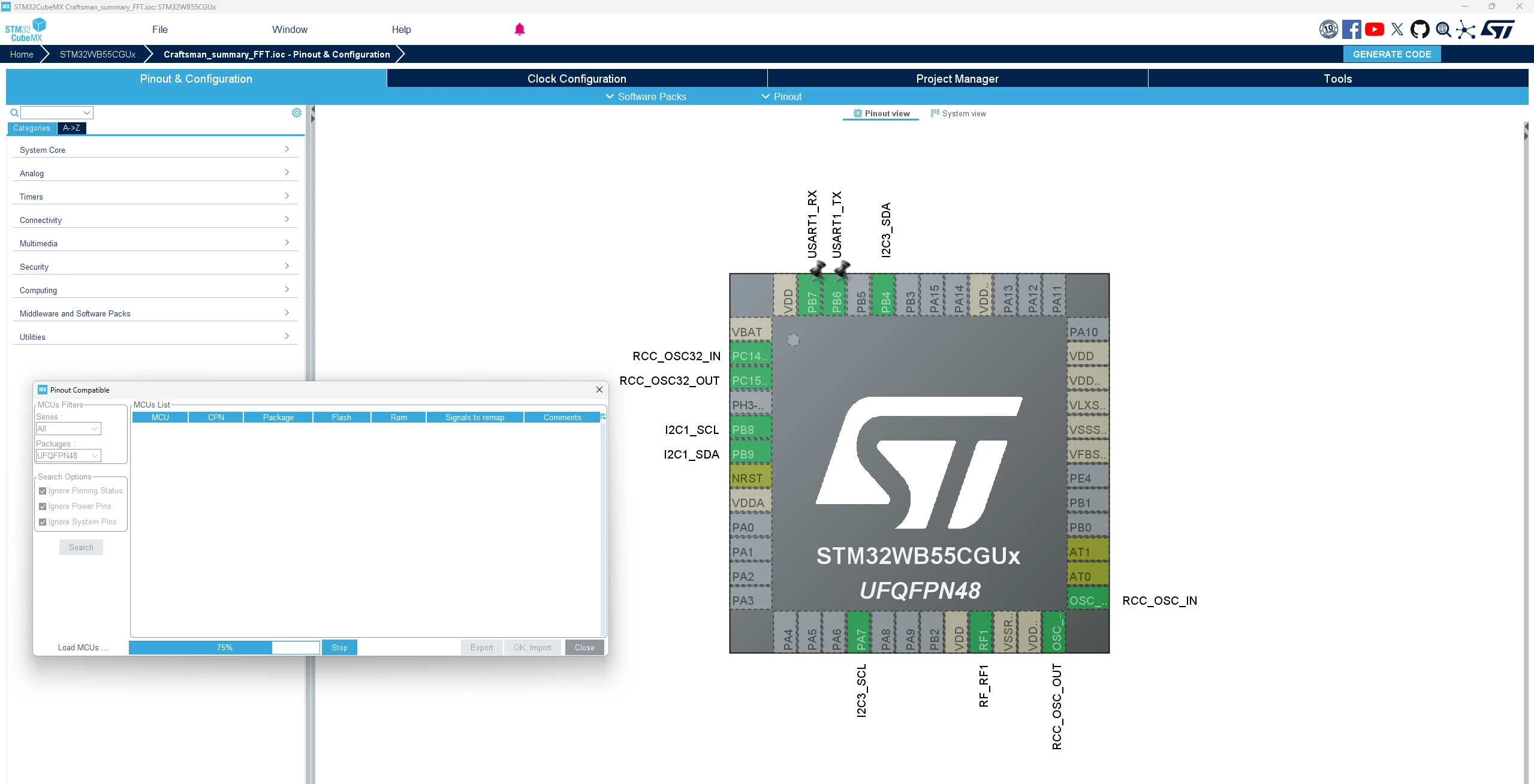

So I tried to retarget it back to an STM32WB55RG in MX but the pinout compatible dialogue just hangs at 75%, see below. So what are my options here? Do I have to open up a new project from scratch & abandon my retargeting via MX?

Hello ​@NicRoberts
The issue is reproduced with STM32CubeMX 6.13.
I suggest that you use the last STM32CubeMX version 6.18

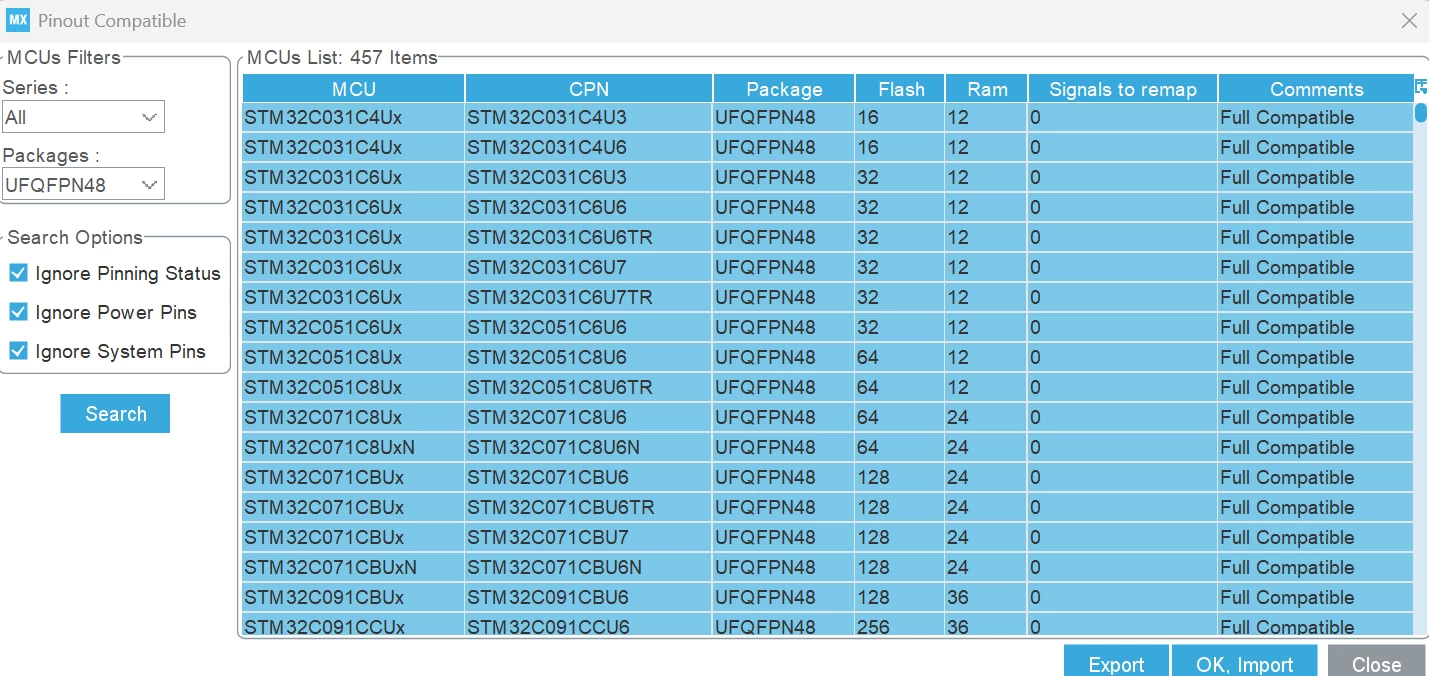

 Hello ​@NicRoberts
Let me thank you for posting.
I reproduced the behavior described using the last STM32CubeMX 6.18 and the issue is not reproduced by my side.

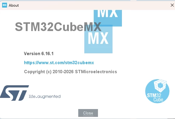

I was using 6.16.1 will update now thanks

Jul 1, 2026 1:30 PM UTC
Yes that worked thanks
