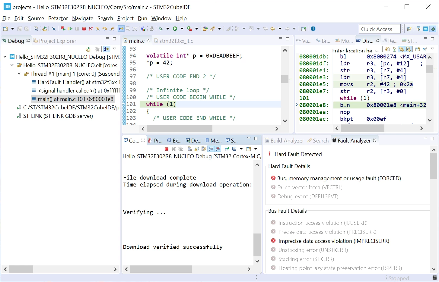

KnarfB
March 19, 2020
Depends on your toolchain. In CubeIDE it could look like:
left. You can walk up the call stack and find out the cause. In the example this is the machine instruction
080001e7: str r2, [r3, #0]
generated from the C code line
*p = 42;
