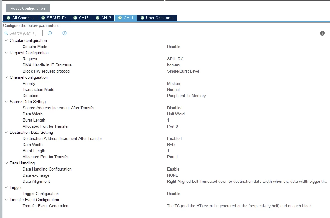

I am using SPI with DMA as shown in the screenshot. DMA is using Data Handling to truncate data from SPI's 16bit buffer into 8 bit values.
The following part of the code errors out. Commenting this code out makes my application work, but every time I change things in CubeMX it is rewriten. Why does this check even exist?
/* Packing mode management is enabled by the DMA settings */
if (((hspi->Init.DataSize > SPI_DATASIZE_16BIT) && (hspi->hdmarx->Init.DestDataWidth != DMA_DEST_DATAWIDTH_WORD) && \
(IS_SPI_FULL_INSTANCE(hspi->Instance))) || \
((hspi->Init.DataSize > SPI_DATASIZE_8BIT) && (hspi->hdmarx->Init.DestDataWidth == DMA_DEST_DATAWIDTH_BYTE)))
/* Restriction the DMA data received is not allowed in this mode */
errorcode = HAL_ERROR;
/* Unlock the process */
__HAL_UNLOCK(hspi);
return errorcode;
2 replies

Why'd you read the peripheral as 16-bit wide, and try and push that out as 8-bit?
The peripheral should be able to decode the width of the access.
Is the SPI in 16-bit mode? If not just be consistent across the board.
btd5Author
March 29, 2024
I am using this SPI to talk to LIS3DHTR accelerometer. I transmit using
HAL_SPI_TransmitReceive_DMA(&hspi1, (uint8_t*) ACC_READ_ALL_DMA,
                                                      (uint8_t*) (acc_value+acc_value_cnt), 32*3);
