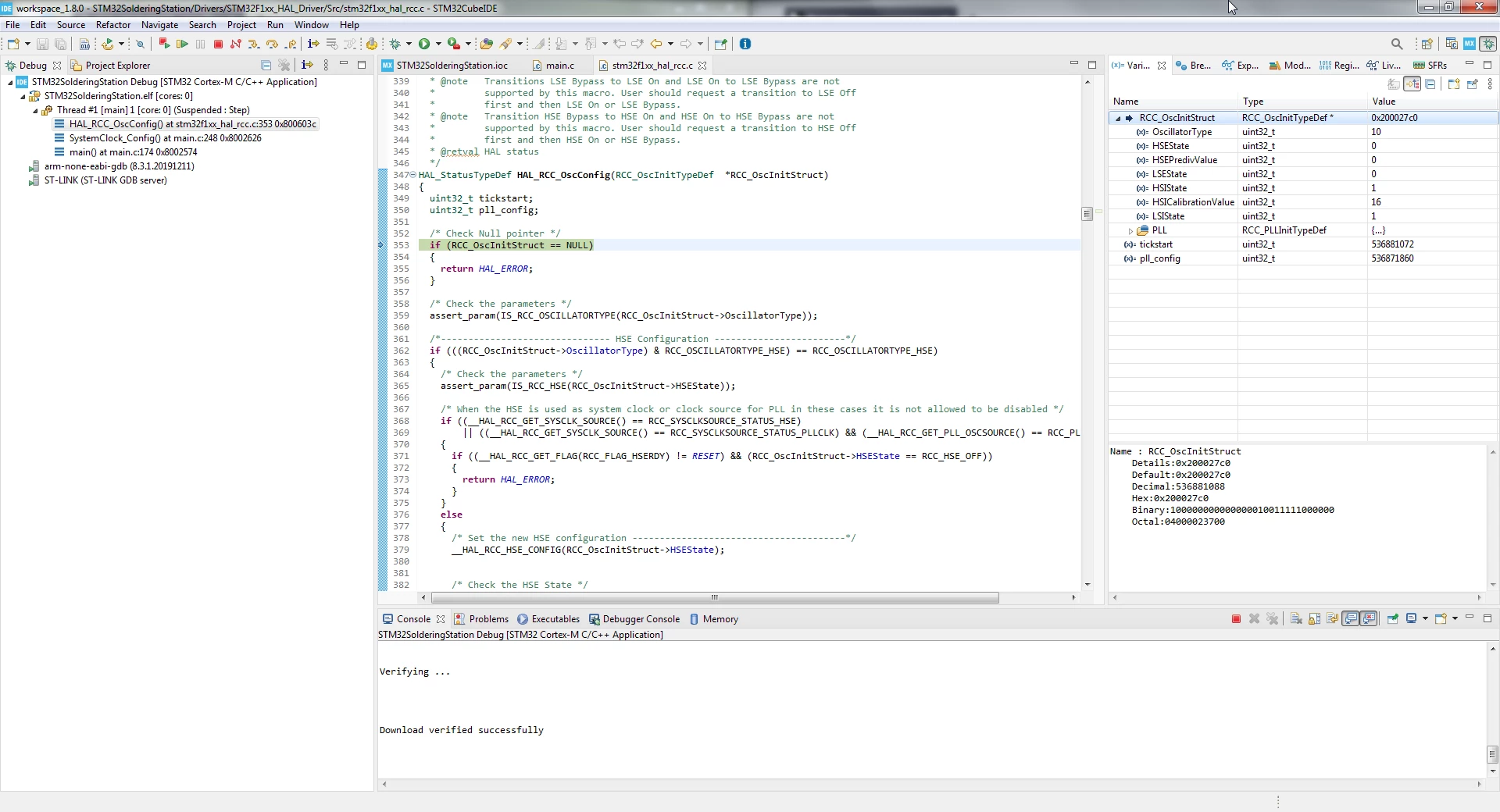

HAL_RCC_OscConfig detects null pointer with a valid pointer?
  • December 3, 2021
  • 1 reply
  • 1050 views
Called from SystemClock_Config.
The pointer is clearly ok, as you can see in the Vars window, but the check detects it as null and exits with HAL_ERROR.
Doesn't make any sense, any thoughts?

Which STM32?
Are you sure it's this check which returns with HAL_ERROR? Single-step in disasm window and observe what's happening in the registers.
Alternatively, switch optimization (maybe only for this particular function) off.
