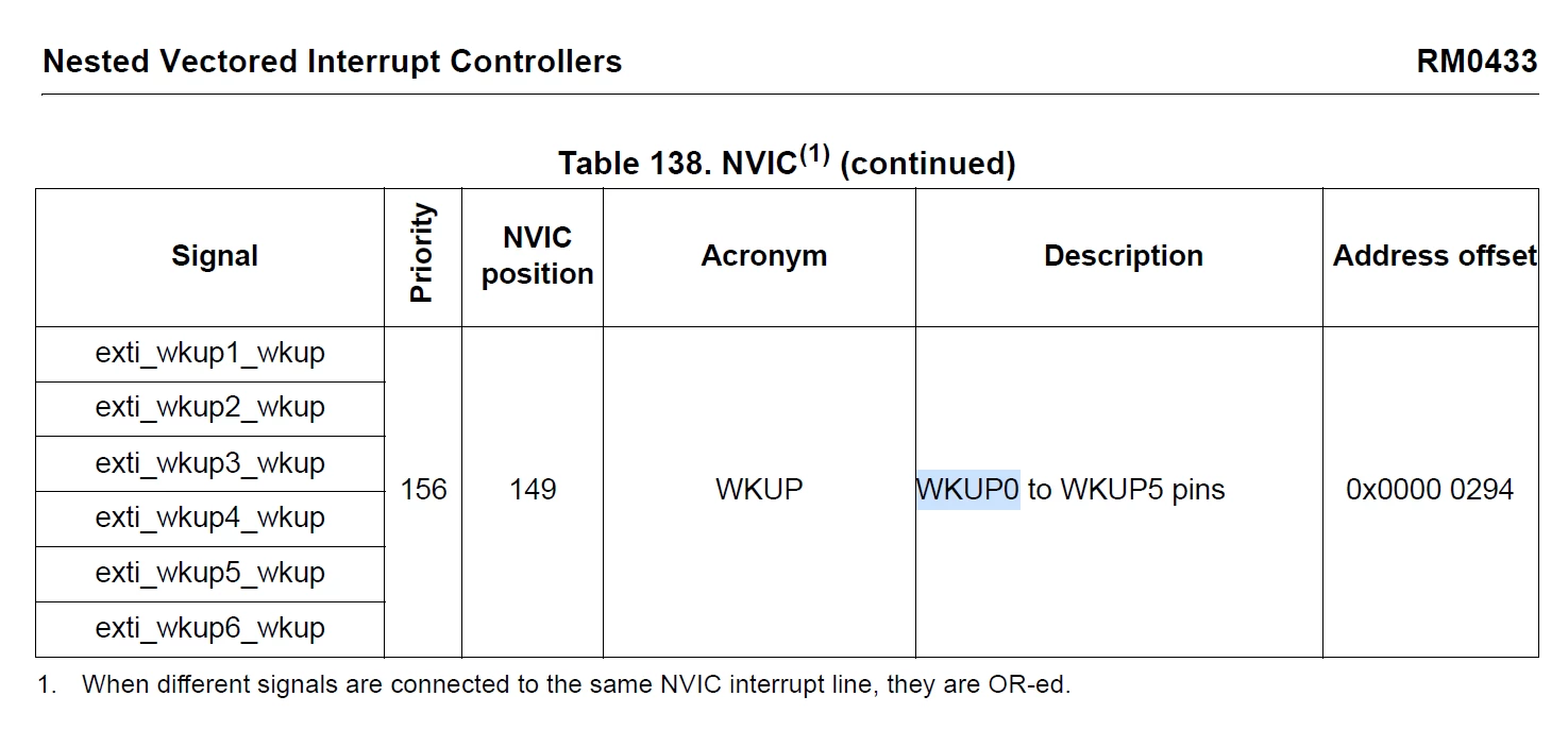

Please tell me why the wakeup pin numbers are shifted up by one in the HAL PWR lib?
See.. https://community.st.com/s/question/0D53W00001DKQdnSAH/wake-from-standby-not-working-stm32h753iit6?t=1637613024141
If there is a legitimate reason for this mapping, then why is it not documented anywhere? I had to infer the mapping and test it by trial and error.

The correct wake-up pins assignment is as the following:
WKUP1 -> PA0
WKUP2 -> PA2
WKUP3 -> PI8
WKUP4 -> PC13
WKUP5 -> PI11
WKUP6 -> PC1
No more WKUP0.
The datasheet with this update will be released soon.

The reference manual lists wake up sources as 1-6 and pins as 0-5.
It is documented in the RM, but it would be less confusing if they shared the same numeric base as they do for other interrupt sources. It's also unclear to the CubeMX user what "Wake-up 0" means.

I'm waking from Standby, not firing an interrupt. Is the information on the NVIC even directly relevant?
The HAL PWR library only refers to pins. "PWR_WAKEUP_PIN4", "HAL_PWR_DisableWakeUpPin()" etc. This is misleading as these defines and functions actually refer to what? Signals? The HAL docs seem to be machine generated and do not say.
I found a few blog posts with examples of how to do it and even ST's example code. Nowhere was there any mention of this little twist.

Actually as you've already mentioned, CubeMX matches the Data Sheet pin assignment and naming . With this being said, I'll raise your point internally to see how we can address a modification in the interface to make it clearer for the user.
Otherwise, I'm adding @Imen DAHMEN​ to review from her side the problem related to the HAL library and confirm the issue.

Hello @FColl.1​ ,
Thank you for your feedback and sorry for the inconvenience it may cause.
I can understand your frustration with the confusion of wakeup pin numbers and I escalated this HAL issue to the appropriate team to take the necessary action.
I would also like to bring to your attention, that there is a known typo in the H7 datasheets:
A swap between PI8 and PC13
  • PI8 = WKUP2
  • PC13 = WKUP3
So, the STM32H7 datasheets will be updated in the Table Pin/ball definition, as below:
1) PI8 replace "WKUP3" by "WKUP2"
2) PC13 replace "WKUP2" by "WKUP3"
Thank you for your understanding.
