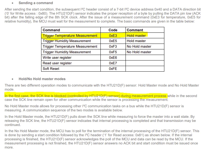

@Anıl Koluaçık​ You can't use HAL_I2C_Mem_Write because it needs a register and data but you're not writing data to the temperature register. Using HAL_I2C_Mem_Read would have been good but if you read over the datasheet it specifically states that you have to wait for the conversion to complete when you write 0xE3. At which time the SCK line is blocked. So that is why HAL is returning HAL_BUSY

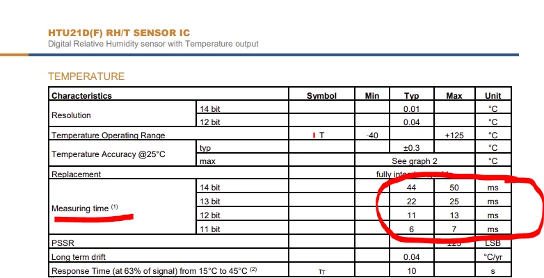

This table indicates how long you have to wait before you can read the temperature data
So...
For doing a soft reset you can use HAL_I2C_Master_Transmit, not HAL_I2C_Mem_Write because you're just writing a register value and not data value.
As for reading the temperature, you need to use HAL_I2C_Master_Transmit to send 0xE3, pause for the given conversion time or check HAL_I2C_GetState. The HTU21D will release the SCK line after the conversion is done. Then you can call HAL_I2C_Master_Receive to read 3 bytes (2 data bytes + checksum) from the temperature register..

akoluacik
akoluacikAuthor
April 15, 2023
uint8_t cmd[] = {0xE3};
HAL_StatusTypeDef res = HAL_I2C_Master_Transmit(&hi2c2, (DEVICE_ADDRESS << 1), cmd, 1, 100);
HAL_Delay(50);
I think this is what you meant, I sent 0xE3 command and wait for 50ms. But I still get the same result.
BTW, I didn't check the whole datasheet, or couldn't understand so I didn't realize I have to wait for a while for measuring process. Thanks for noticing. And also special thanks for your response and interest.

	HAL_Delay(100); // I tried different values
	sprintf(output, "res:%d\r\n", res);
	HAL_UART_Transmit(&huart1, (uint8_t*)output, strlen(output), 100); // returns HAL_ERROR

One part that I still cannot understand is that, I researched somewhere else they realized that if there are more register in an I2C device, then we need to use HAL_I2C_Mem functions, however, if there is only one register, we can use HAL_I2C_Master functions. Is that true? And I couldnt understand my device if it has more memory registers? Because it is said, for instance,0xE3 is a command, not register. So I am using HAL_I2C_Master rather than mem functions. Is that OK?
I am so newbie for this concept. I am sorry if I have been persisting on my mistakes. They aren't on purpose.

@Anıl Koluaçık​ From the datasheet, this device has two I2C modes: with SCK stretching (so called "hold") and without (called "no hold"). Usually for STM32 as master, you want the "no hold" mode.
In that mode, the device won't respond to commands until the measurement is ready.
This allows working with other devices on same bus while HTU21D is busy with measurements.
So you can just try reading periodically until read succeeds (or call HAL_I2C_IsDeviceReady until success, then read).

I tried you suggestion sir, however the device is ready, I still get HAL_ERROR when transmitting 0xE3.
Pavel A.
April 16, 2023
Well, this is already not HAL_BUSY.
What does HAL_I2C_GetError() return?
