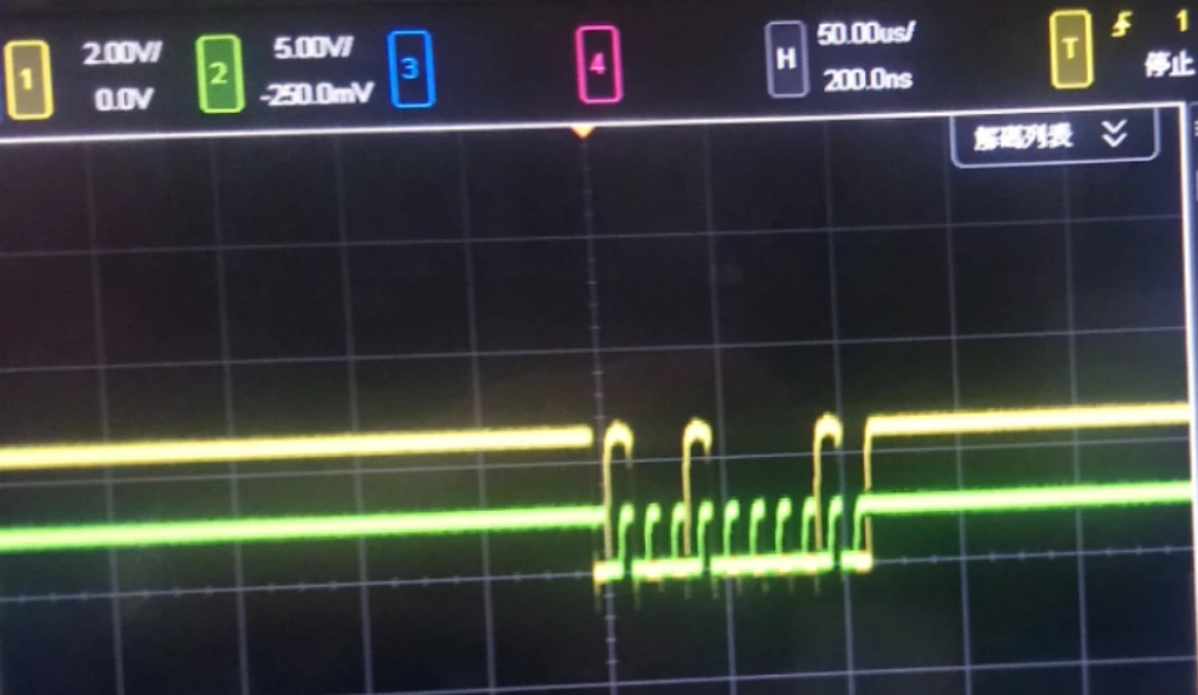

HAL_I2C_Master_Transmit always returns != HAL_OK
I am using STM32 Cube MX to generate 32L443RCTx code.
In function HAL_I2C_Master_Transmit always returns != HAL_OK
Any ideas why?

waclawek.jan
Dec 10, 2020 6:31 AM UTC
And what is on SDA/SCL when observed using oscilloscope/LA?
STai.2
STai.2Author
Dec 10, 2020 7:30 AM UTC
Only reply 0x90
SDA/SCL As attached file
waclawek.jan
waclawek.janBest answer
Dec 10, 2020 12:02 PM UTC
There's a NAK at the end, i.e. the slave does not answer (it's not present, not connected, not working...)
STai.2
STai.2Author
Dec 14, 2020 6:06 AM UTC
Working
Thanks!​
