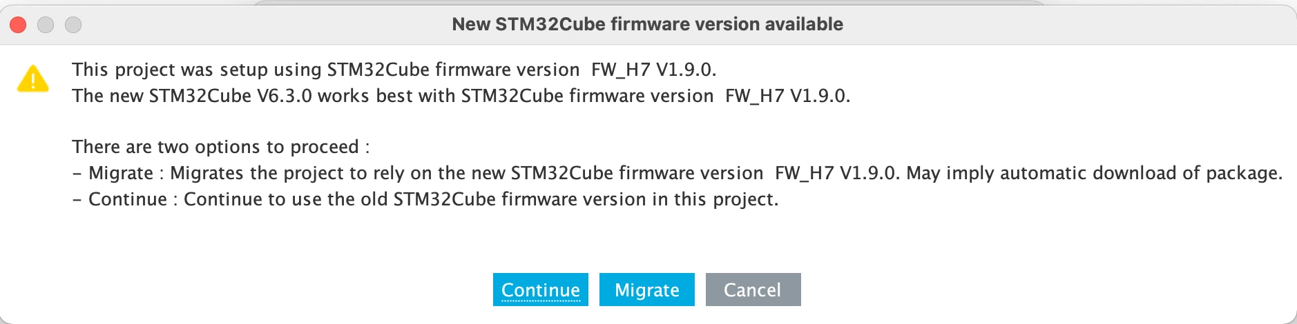

Hi @MEdgerton​ ,
I tried your project successfully, but if I open the Cube to change the pinout by trying to open the .ioc file, it asks me to migrate the project:
If I choose to continue, I get a blank cube application, and if I migrate the project, I am unable to compile the project.
So I tried opening new project using you .ioc file, and add all the .c files to then project, no I am able to compile, but I get hardware fault. I tried looking through all the files and there is no diff. Any idea what I may be doing wrong?
I have attached the migrated project file
Any insight is appreciated.
