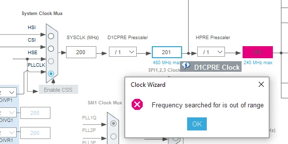

H743BI: Can't setup CPU clocks above 200 MHz

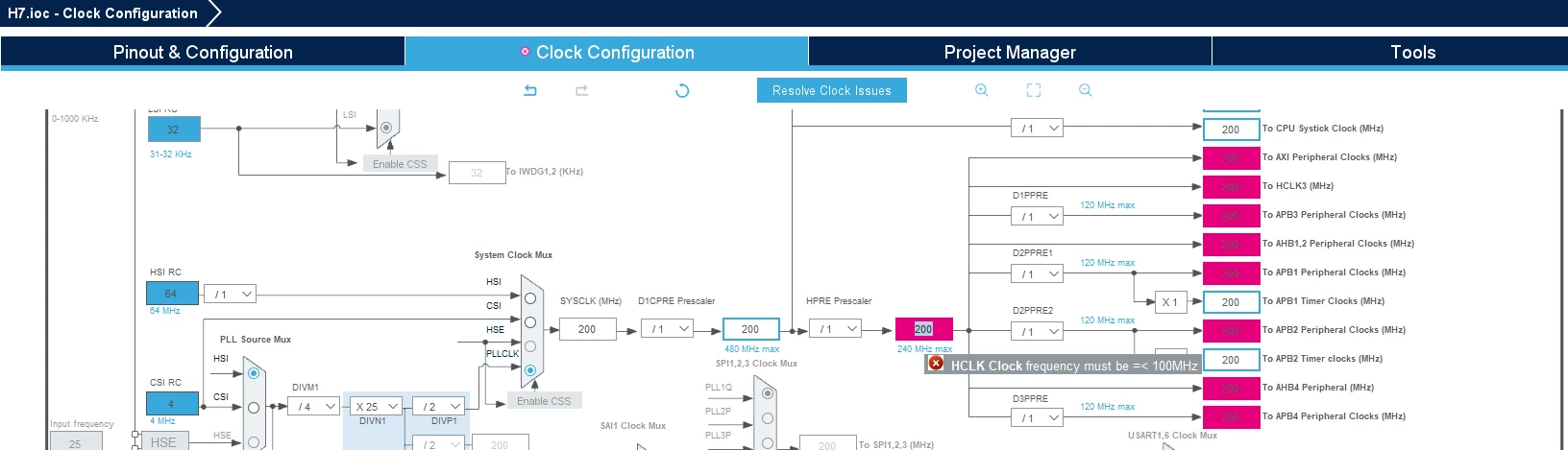

try setup clock above 200 Mhz (try for revision Y and V) and get error:
Error has occured also if you try set D1PRE set above 200 Mhz:

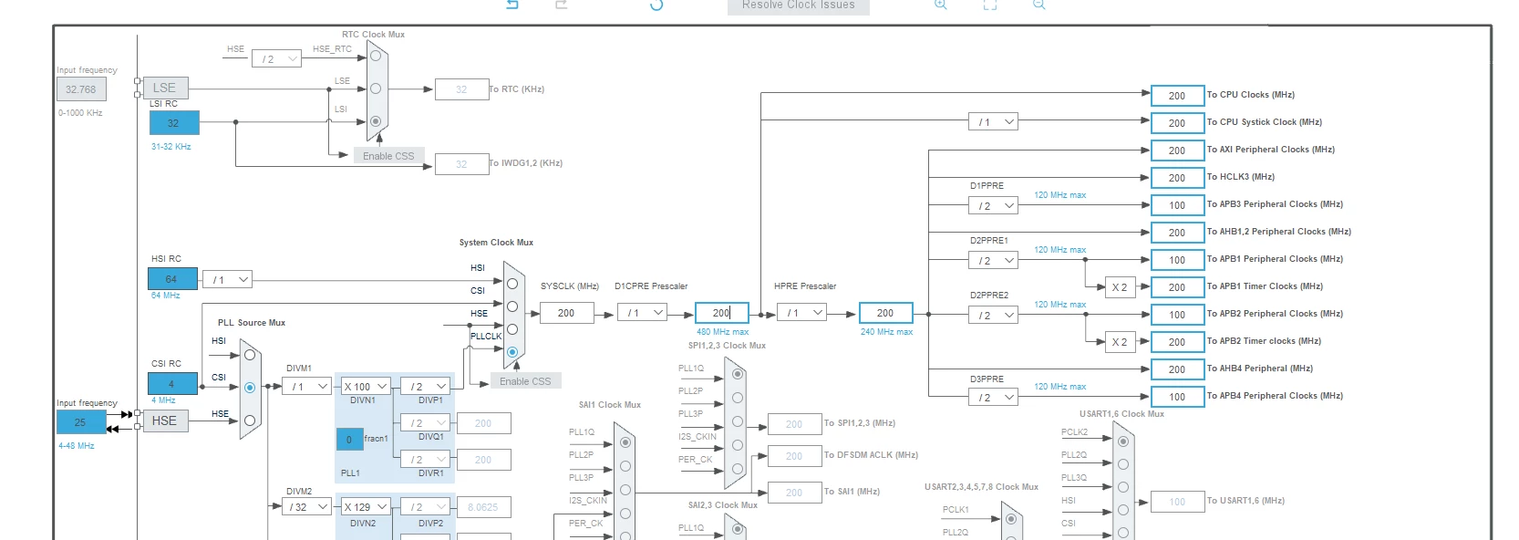

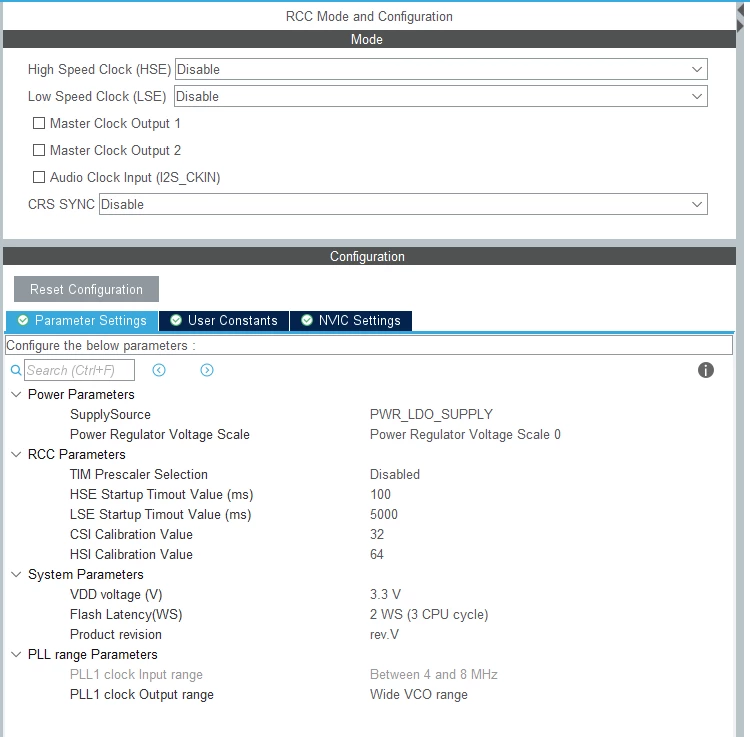

Hello @kamil Duljas​ ,
You can try :
_legacyfs_online_stmicro_images_0693W00000bjrD6QAI.pngIt's fine now :
Foued

Ok , thanks. It is not intuitve enough.
